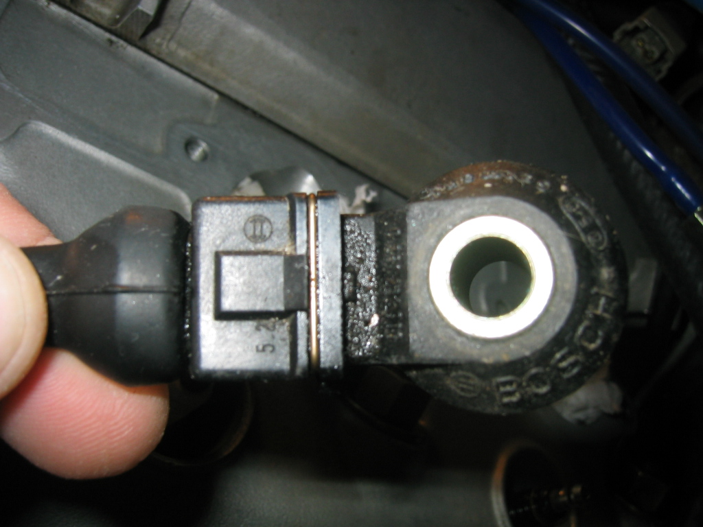

where do I find the knock sensor on a 98 lgt?.....I was talking with the parts guy at norms he said that it was as simple as taking out the air box and finding it......did that.....still couldn't locate it...help...?!

ya i would say under the intake also near the alt.
Rightseat
under intake mani on top of block, toward right rear of motor when you are standing in front of car in wrench-ready position
it's super easy to remove, one elec connector and one bolt.
be aware that the KS is a directional piece, and will not work correctly if not installed at 60-degree angle off centerline of engine. note precise location of the piece you remove, put new one back in exact same location...you'll get fewer CELS after installing the new part!

no its towards the back, near the brake booster.
you shouldnt need to take off anything on an n/a car. you need a long socket set with an extension. its probably like a 16mm or something. the sensor is just behind the back right intake mani arm, and its screwed right into the block. the single wire going to it has a couple connectors, disconnect the one closest to the sensor. its $90 for a new one at most places. its takes 5 min and one socket to install it.
