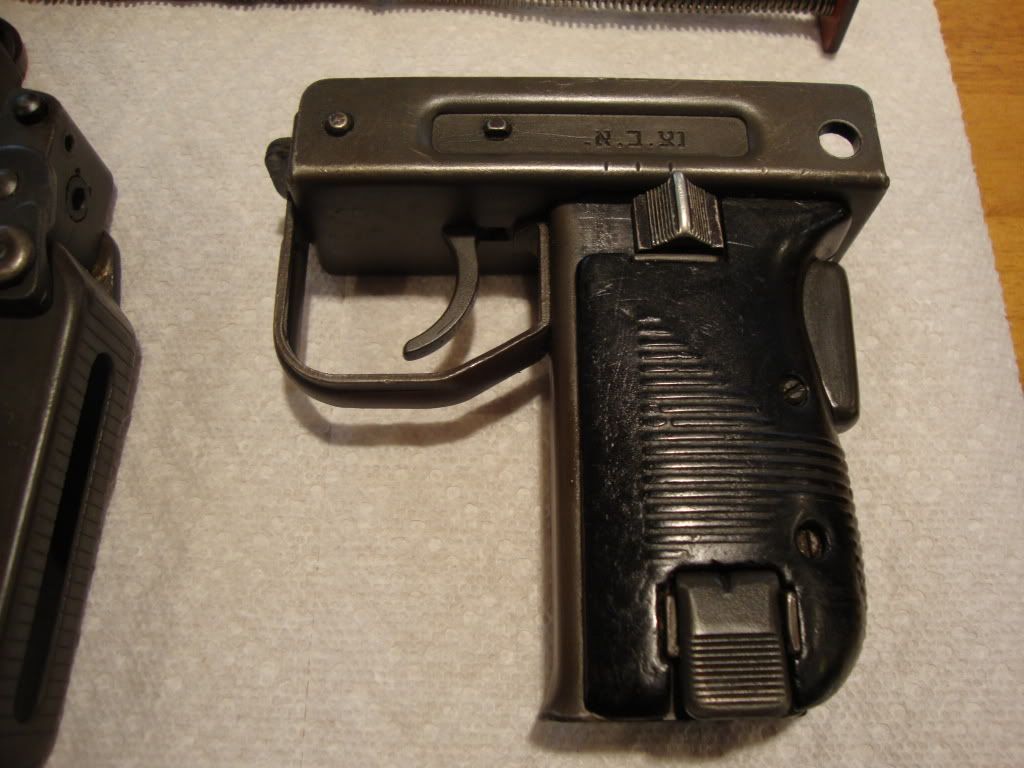

Anyway, here's the parts kit as I received it-
And the cool Hebrew selector markings on the grip frame
