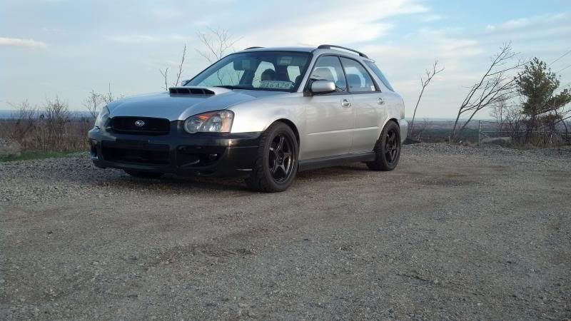

hooligansti
If you can find them Federals 595rs-rs or 595 EVOs are fairly cheap and sticky. I'm running 17X9 +42 with 255/40 595rs-r on my Wagon. The 255s fit nice and square on the 17x9s. I ran 245/40 Yokohama A048s last year when I got the wheels and they looked pretty square as well. The rs-r run wide so you could probably stick a 235/40 on a 9 without much of a stretch. My 255s look more like 265s. Picture for visual reference:
I'm on coilovers as well but mildly low. My fenders are rolled and pulled a little to fit the 255s on the narrow Wagon body without rubbage. A sedan should have less of an issue with tires this wide.
