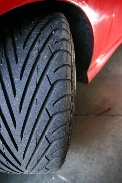

I run the 235 in the front and a 265 in the rear
