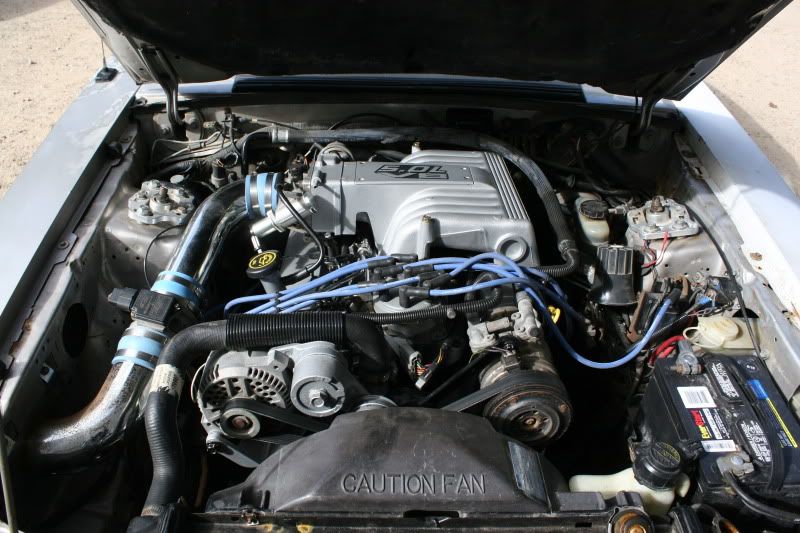

This is what I did this fall:
250 miles later, I blew up the trans doing a 1st gear burn out into a 2nd gear power shift.

What intake manifold is that?
Pops and I are pulling the 5.0 from his race car this weekend. Stock 5.0 with just a procharger and 1xx,xxx miles. Forged rotating assembly, I think so.
What trans did you pooch? T5?

The motor is a 99 Explorer 5.0 with the GT40P heads. I installed a Trickflow Stage 1 cam and valve spring kit before I put it in the car too. Yup, was the T-5. The needle bearing cage under 1st gear exploded. Replaced 1st & 2nd gears and a syncro kit (I have the rebuild vid if ya need it, lol). That was about 4k miles ago, lol. I wont show any pics of the drivers side as she isn't a beauty queen and has some cancer. She has it where it counts now tho...
