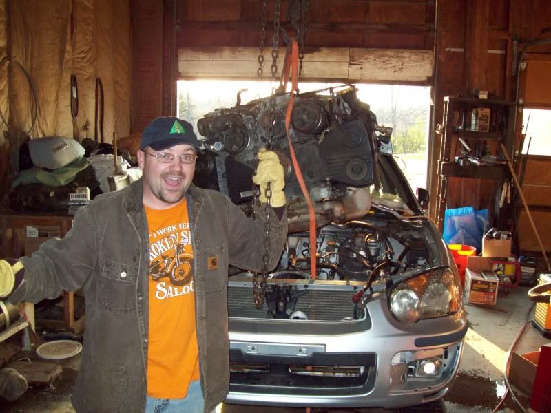

the motor is finally out after being so unbelievably stubborn:

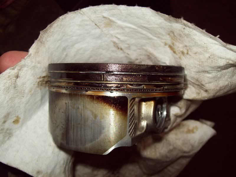

what caused the new block to fail. remedied by a new set of pistons:
