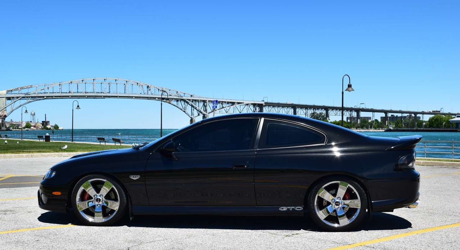

Just installed the new wheels today: Ruff Racing R357, 18X8 with Dunlop Direzza DZ102. Exactly the look I've been longing for with this car! Maybe I'll do the suspension next summer.

Hi, I have a 2004 GTO with 14" Wilwood Brakes on the front , I'm wanting to purchase the type of rims/wheels you have on your car but the supplier says they won't work with the 14" Wilwoods but won't give me a reason why they won't fit.
I see you made some mention of putting aftermarket brakes on your GTO & am wondering if you did do this yet & if so what size calipers did you put on ... Thanks, Steve
Boostin11STI
I have stock brakes, just upgraded pads. If I had to guess I'd say the Wilwood calipers will not clear the inside of the spokes. Same peoblem I had looking for aftermarket wheels for my STI with the Brembos. Again, just a guess because of the spoke design and offset.

Got the Rims in today & did a test fit, they look like they will work without any spacers. I have 1/4" clearance from the face of the 14" Wilwood Caliper to the closet point on the spokes & 3/16" clearance in the inside of the rim to the edge of the Caliper.
[SIZE=13.3333px]Had the tires mounted & put one on & it looks like there's plenty of clearance for the tires too, they stick out just a little bit more than the 245/35/19 do but their 245/40ZR18 tires so I expected that ... [/SIZE]
