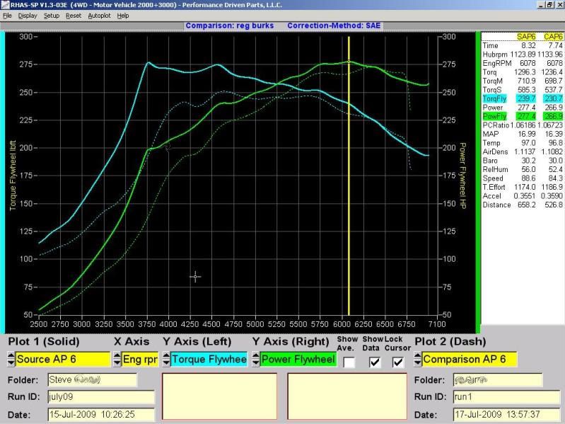

I was going to do a VF39, but then I saw the Dyno results of a TD04 19T. It spools way faster than the VF39 and I can still hit my power goals close to 300 whp. There's lots more info on Nasioc and examples of the VF39, but the 19T sounds way cool. Not to mention it seems a bit cheaper.
This picture was on Nasioc, I don't own it, I don't know if that's in issue... but the solid lines are the TD04 19T and the dotted lines are the VF39.
The TD04 mods list is:
Stock 2.0l
TD04-19T ported and clipped
Ver 8 JDM TMIC
Stock air box with Subaru AA080 filter
GM EBCS
APS turbo inlet
Pink Injectors
STi up-pipe
Stock mid-pipe to Prodrive Axle back with a Invidia down-pipe
VF39:
Stock 2.0l
VF-39
e-bay TMIC
APS 65mm cold air
Pink Injectors
catless up-pipe
full 3" turbo back
Might be fine. I would be concerned about that torque curve on an otherwise stock block if you plan to abuse it at all. Definitely will need a solid tune to be long-term reliable.

I don't plan on abusing it... When I had the work done, Meyagi said he's been running a VF39 on the same 2.2 block. His was used, mine is new, so I have an advantage there. He has it in his Ken Block car, so he's been beating on it for about 3 years, he told me. I definitely don't want to push it to it's limit, since it's a daily.
I was drawn to the TD04-19T since it spools faster. I'd rather get the power faster than have a lot of power overall.
My torque curve comment is related to the TD04-19T.  The vf39 would be fine.  Folks run those all day long no issues.
Spool/power faster means more force on the rods/bearings.  Just saying that IMO it'd be risky without the right tune on stock internals.  Don't want that power slamming on.  Needs to be smooth.  If it was forged rods/pistons I'd throw power at it as fast as it wouldn't knock ;-)

Oh, I see what you mean. You're not worried about the torque, you're worried about the torque hitting fast.. That's a good point.
It would definitely be going down to Kinetic for a solid tune. Are you worried that it's an N/A block rather than the 2.0 turbo block or just that it's not built regardless of the block?
