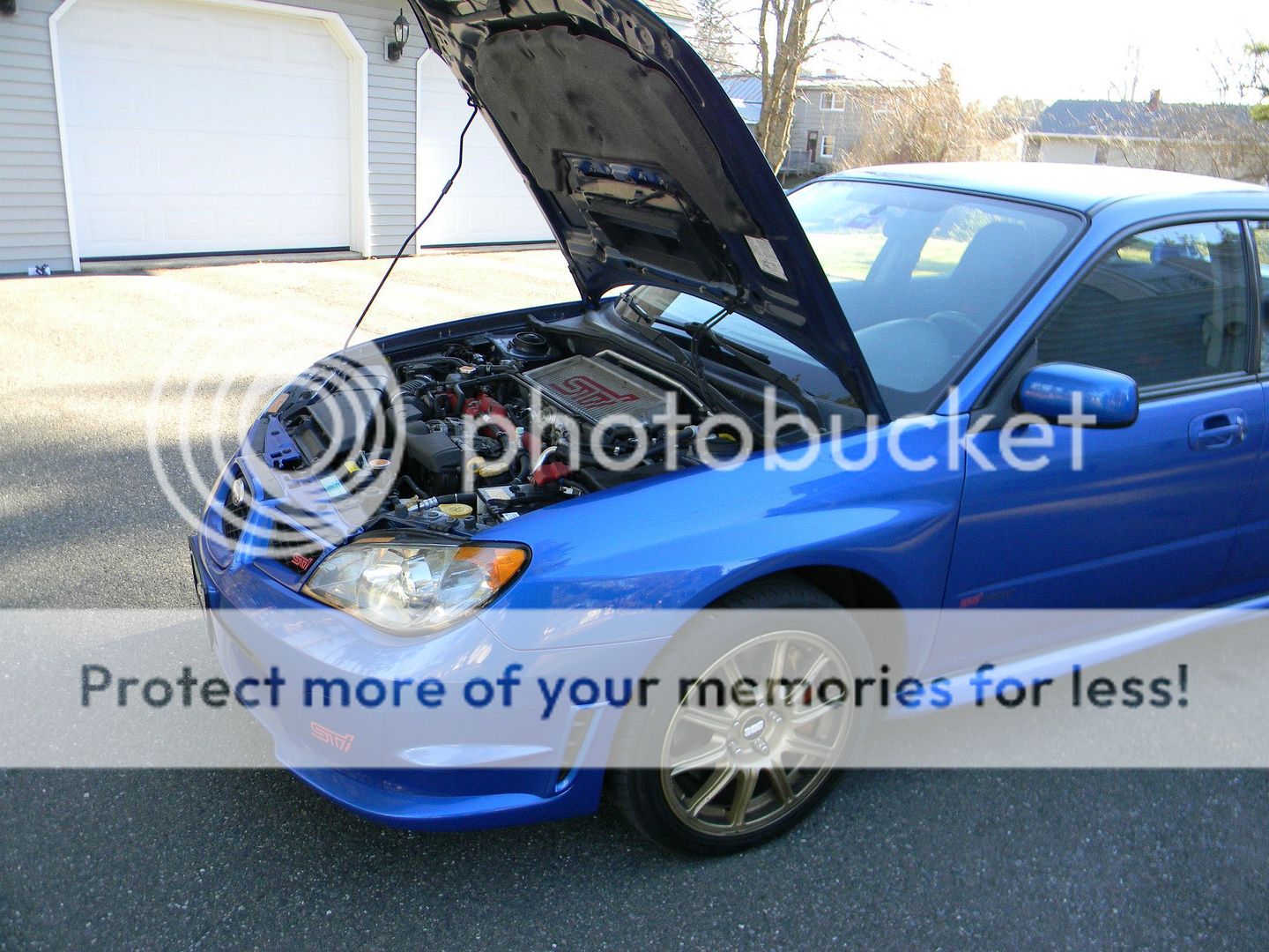

Bought this car in December of 2012 with about 40k on the clock. I figured since I'm doing a build thread on the 2000 Impreza, that I ought to start one for the STi. Here's a list of mods as I installed them. I'll be inserting pictures as I sort through my SD cards, but here's what it came with:
Stage II
-Generic (looks like grimmspeed) downpipe.
-3 Port BCS
-Horrible choppy tune
Here's what I did the first month:
Tactrix tuning cable was ordered
-Installed a boost guage in the ash tray area, kinda stealthy
-Flashed a generic 'OTS' stage II map, adjusted the watsegate tables to take advantage of the 3 port.
-Bigger TMIC installed. (Put my stocker on the wifes WRX)

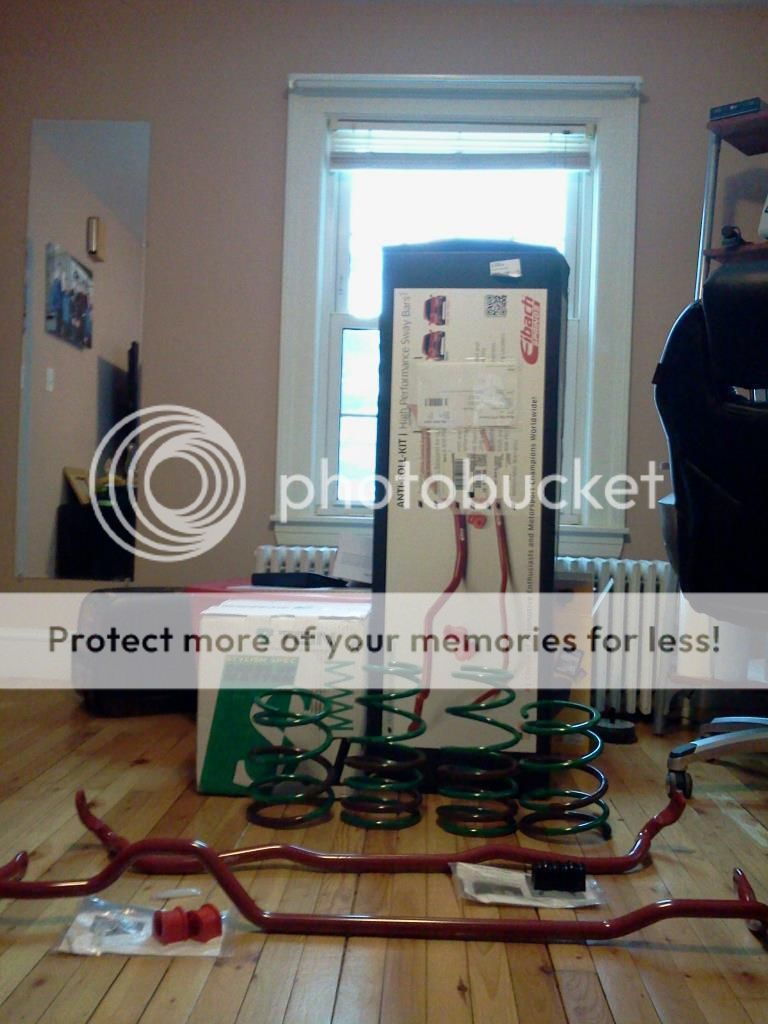

-Eibach Front and Rear adjustable swaybars
-Kartboy Endlinks
-Tein Springs
-Killer B Oil Pickup (if you don't know why, you should look it up. It could save your motor.)
Then I had to go away for some military training... when I came home I continued with :
-Perrin EL Headers
-New headunit
-Small Sub Box and amp
-K&N Panel filter
-Built a turbo heat shield out of diamond plate
-Traded the larger TMIC for a stock 2011 STi TMIC because they have less pressure drop and are more efficient than most aftermarket ones.
-Modified the hood scoop to get air over the whole top mount.
-Retuned to add a bit of timing and revise the target boost tables.
The car was really starting to come into its own at this point. It was very fast even comparing it to my 08 WRX with an AVO 380 and protune. The only time it would have issues was on hot days, so it was time to start combating heat soak.
-Bought an AEM water meth injection kit
-Picked up an AEM wideband
-Installed the wideband first and did a ton of datalogging
-Set up the water meth and did a couple runs. It comes on at 5 psi and maxes flow at 19 psi.
-Did some logging, advanced the timing a bit.
-Did more logging, turned up the boost a bit
Time for a test run at the strip. I took it up to Winterport with a friend of mine, he's got an 04 STi with a GT30R, 850cc injectors, and unknown internals on the motor. All I know it that it revs fast and hard and is like a damn space shuttle at WOT. Neither of us wanted to launch the cars because it was a 70 mile tow truck ride back home if we broke something. At the end of the day I was able to trap 82 MPH to his 83 MPH, but I beat him on time by a tenth. I pulled somewhere in the 8.2 range. Needless to say, going against a built STi with a GT30R and being within 1 MPH at the end of the 1/8th made me happy. I have no doubt that in a 1/4 mile he'd be walking away though.
Now the car was really hauling ass, it was having trouble keeping all the power on the road. Back to traction.
-New Sumimoto HTRZII 235/45/17 tires (This size also fixes the speedometer error)
-New ceramic brake pads all around
The new tires did the trick for the time being, but it was now Winter and it was being rarely used. Next stop Christmas.
-Perrin Wing Stiffies
-Short Throw Shifter
-New exhaust
-GrimmSpeed Crank Pulley
Still not using the car much because I don't want to ruin it. So it was run sparsely up until the tax return
-PST Carbon Fiber Drive Shaft
-PTP Lava turbo blanket
-Mishimoto Gold Heat tape
-Wrapped the intercooler in the heat reflective tape, also did the back side of the heat shield
-Re tuned to maximize the new lower, more consistent intake temps.
-Pulled all of the interior out and dynomatted everything
But now I have a strut that's going so time for some Spring Projects. Looking for better handling and more boost because even at 19 psi with water meth I'm not hitting 100% Injector Duty Cycle.
-Just ordered a set of Fortune Auto 500 Coilovers
-Also on the way, Blouch 20G XT-R with the newer 48lb/min wheel in it.
