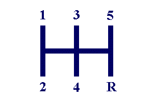

Problem #1, as discussed in another thread:
My shifter does not automatically return to the center of the H when out of gear (from the 1st/2nd area, but returns from the 5th/reverse area) so I think that a spring is busted or something. Question: Is it a spring or a bushing? If a bushing, will the Kartboy bushing fix that?

kartboy bushings will NOT help that. there not what you think they are. there more of an engine mount. what im doing this weekend should help with that, you have to replace the shifter yoke in the linkage they get worn out and get sloppy. granted to do so you need to drop a cross member. as for a spring to pull it back to center, if there is one. its in the transmission and not easily accessible.
there IS a spring to help return the lever to center...it's on the outside of the trans up top in the shift linkage itself. you can get at it OK without dropping trans or exhaust, but it's tight. You need to have skinny arms and reach up past exhaust to reach spring, so jack car up securely and wait til things have cooled down to try the job. there may be a heat shield in the way, if so, you may have to reach the spring from inside the car--pull center console and outer/inner shift boots for access this way. look for a parts diagram online to see what we're talking here.
