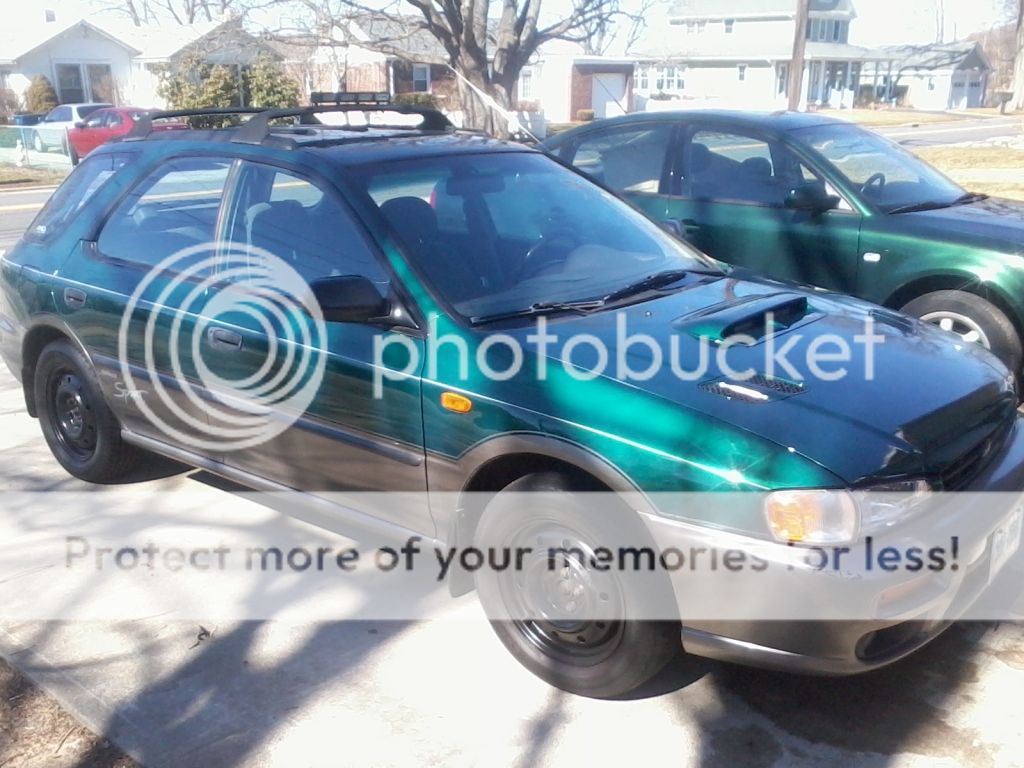

This was the car the day I bought it
an hour later... had these sitting in my garage

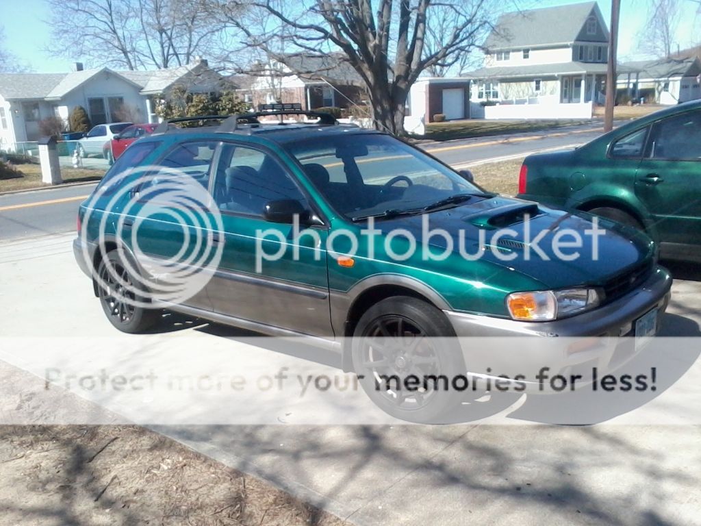

Good looking wagon . Looked sweet with those black wheels
I did like the black wheels but the tires were shot and the right rear had a bing ding in the lip although you cant see it in the pics. It's a pretty clean car, have a tiny bit of rust to fix before it gets noticeable

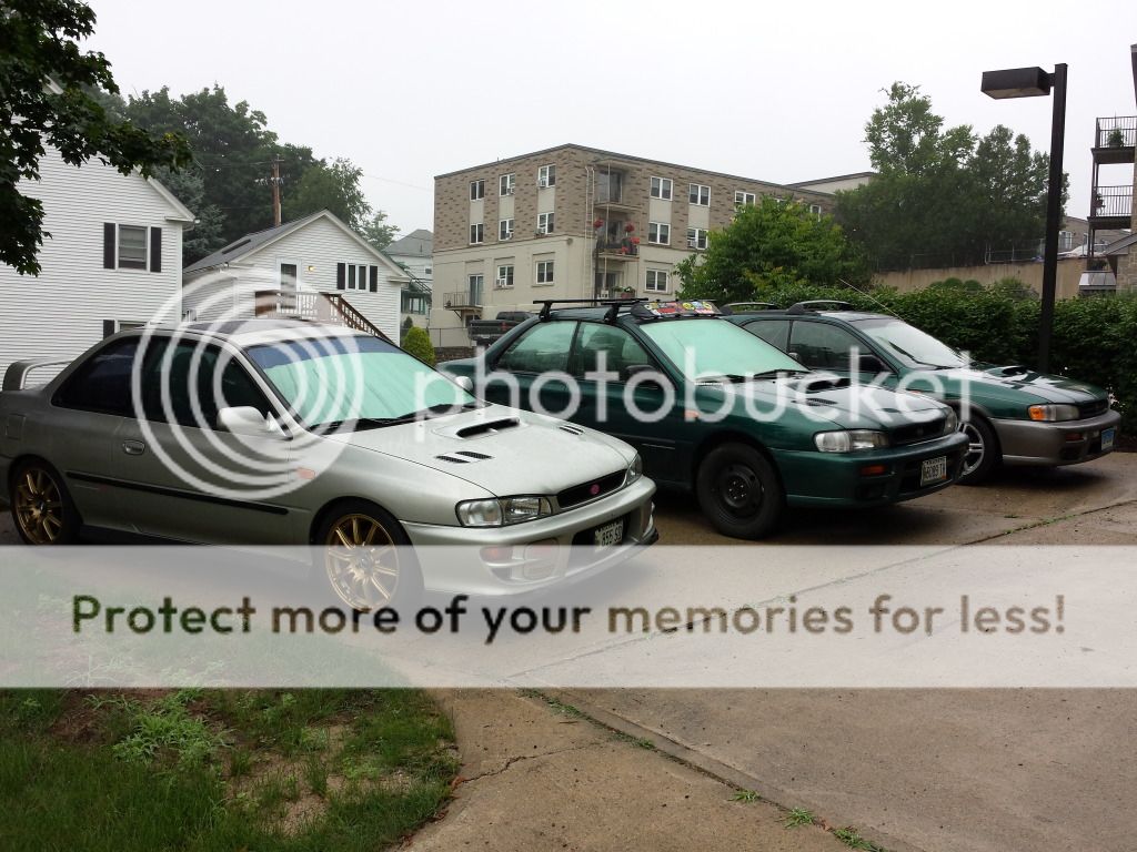

Met Rick today, cool guy! and your RS got the turbo itch back in me.. so I may pick up another motor and start doing work to it. I have a set of EJ22T pistons but they are all size B so I would need to find a 2.2 block to match that.
Pic from today
