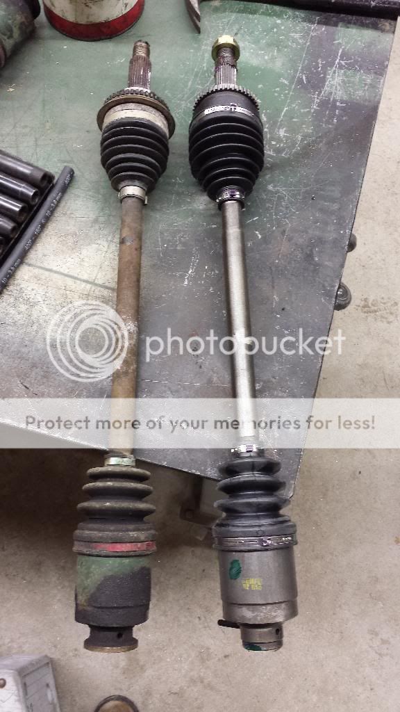

Here is a picture of the old drivers side cv shaft next to the brandy new one.  12$ deposit for the core at Napa so I'll be bringing the oldies back.  What is the core made out of that they need a deposit?
I ended up buying two from Napa because they were not that expensive and rather have them done now then have to do the other one again in the future.  I used an air impact gun/wrench to get the axle nut off.  I did the drivers side first and it was a breeze.  Had to fumble around with the passenger side for far too long trying to align the pin holes up properly.  The replacement/install went smoothly.  Took the car for a test driver and it no longer makes the noise, there is also no more pulsing or thunk thunk thunking.  I'll be driving the car to Portland tonight so that will be a good test to see if this fixed the problem.  But as of now the car seems to ride smoother and there are no noises.  Thank you to everyone for your help and input!
The core is so they can refinish it, and put new cv joints in it. Cheaper for that company to refurbish old cv axles instead of making them brandy new. If you bought a new axle, there probably wouldn't be a core charge.
