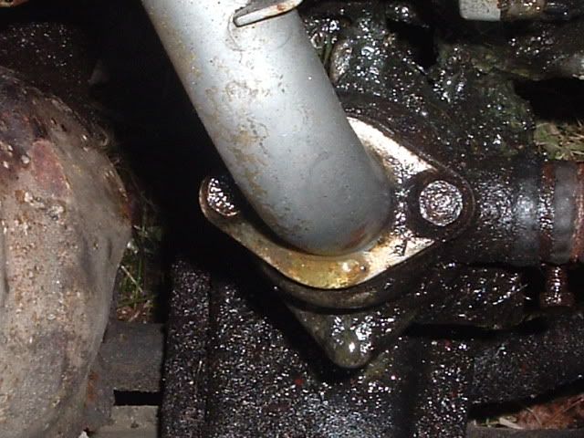

ok, I'm a noob, and Im trying to get the Justy up and running. Its been a pain in the ass.
here are some photos.... can someone please explain to me where the liquid is coming from?... I believe its anti-freeze.
and .. if something major... do you think its worth the fix?
Runnah
It looks like on pic one that if that is the source of the leak, then it may just need a gasket replaced.
Runnah
ok. ive replaced the valve cover gasket... would it be the head gasket?
You'd be seeing oil not coolant.

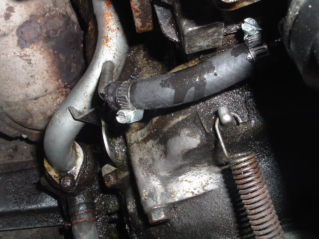

On the second pic the middle hose looks like something has dripped on it. Check above that area.
Cooling systems are mostly simple rubber hoses and clamps. Odds are is that you have a worn out hose or a broken clamp somewhere.
Start at your radiator and work your way out, checking each hose for holes and clamp integrity.

alright ill check it out. the hose in the second pic is actually new, and it was leaking from there before i changed it, Thanks!
