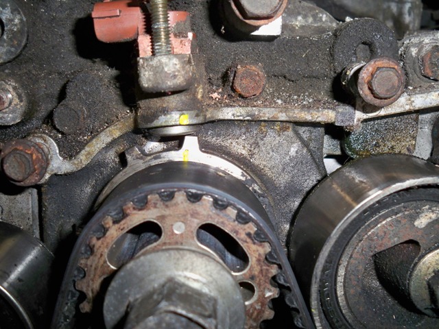

Just changed my crank gear and also my crank position sensor. Now i am not getting any spark at all. I am thinking i may have ruined the sensor i had to jam it in pretty hard and its not all the way in. How close does the sensor have to be to get a reading? Anyone?
I'm not hugely familiar with that sensor but it might have to be seated fully. Although I would think you'd get a check engine light if the sensor wasn't reading right.
If there is an issue with the crank sensor you probably won't get a code at all. It does need to be seated fully.
It gets very close to the teeth on the crank gear.  Random image off google
The sensor is pretty delicate too.
