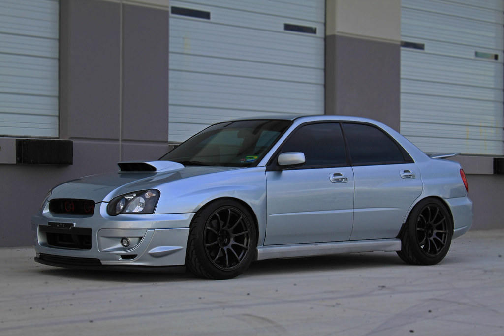

I want something with this look (and these are the wheels I'm probably getting)
I PMed him and asked him about his setup. They are 18x9 +35 G-force wrapped in 245/40, but he had to sell his KYB struts in order for these wheels to fit, and I'm running KYBs
. I really just want a wider wheel and tire set up...
Those fenders look rolled and pulled. Not to mention you need coilovers not only for the stiffer (keep down the wheels travel) ride, but for clearance on the inside of the wheel. Normal spring/strut combos are way too wide. Factor in a new alignment with negative camber.

...you need coilovers not only for the stiffer (keep down the wheels travel) ride, but for clearance on the inside of the wheel. Normal spring/strut combos are way too wide.
It looks good, but its silly.
^that.
be very careful with any wheel/tire setup that requires you to restrict or reduce wheel travel. wheel travel is what makes a subaru drive like a subaru. yes, they roll a little but on rough roads (like every effin one in Maine) it's a worthwhile tradeoff.
that is, unless you want to make your nice Subie ride like a slammed Honda. the silver car pictured may look groovy but would be a stupid setup for Maine roads.
