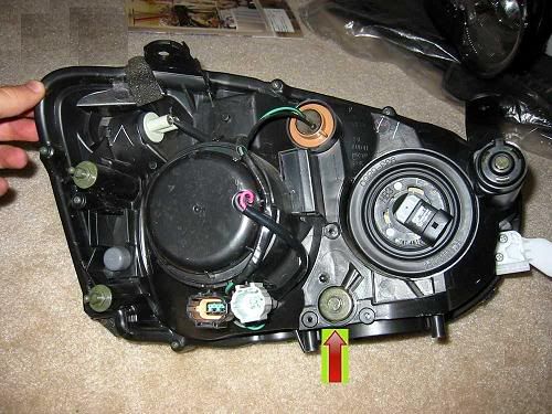

anyone know how to adjust the stock HID's? my driver side low beam points to the sky and i can't figure out how to bring it down. The 3 setting adjustment motor is working and moves it even higher so i need to bring it back down to the level of the passenger side. any idea??
thanks!
theres a white square that sticks out that i think is an adjuster. i put a 10 mm wrench on it and spun it but it did nothing. is that the only adjuster?
8mm socket. I believe right=up, left=down.
Here is a link of "how to aim these correctly"
http://www.danielsternlighting.com/tech/aim/aim.html
