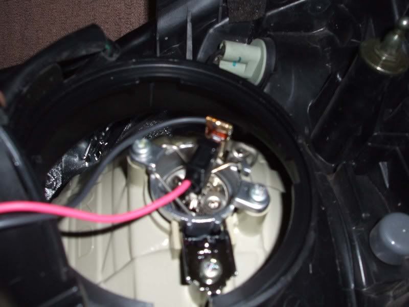

well to my next question. I got another headlight plug wire to put the stockers back in but it only has one wire to hook into the possitive.. what do I do about the ground that's spliced into the harness for the HID ballest
I'm assuming you're talking about the low beam h1 slot for your peanut eye. If so the hot lead should connect to the bulb & the ground should connect to the prong off the bulb holder base. The slightly out of focus pic below should help
