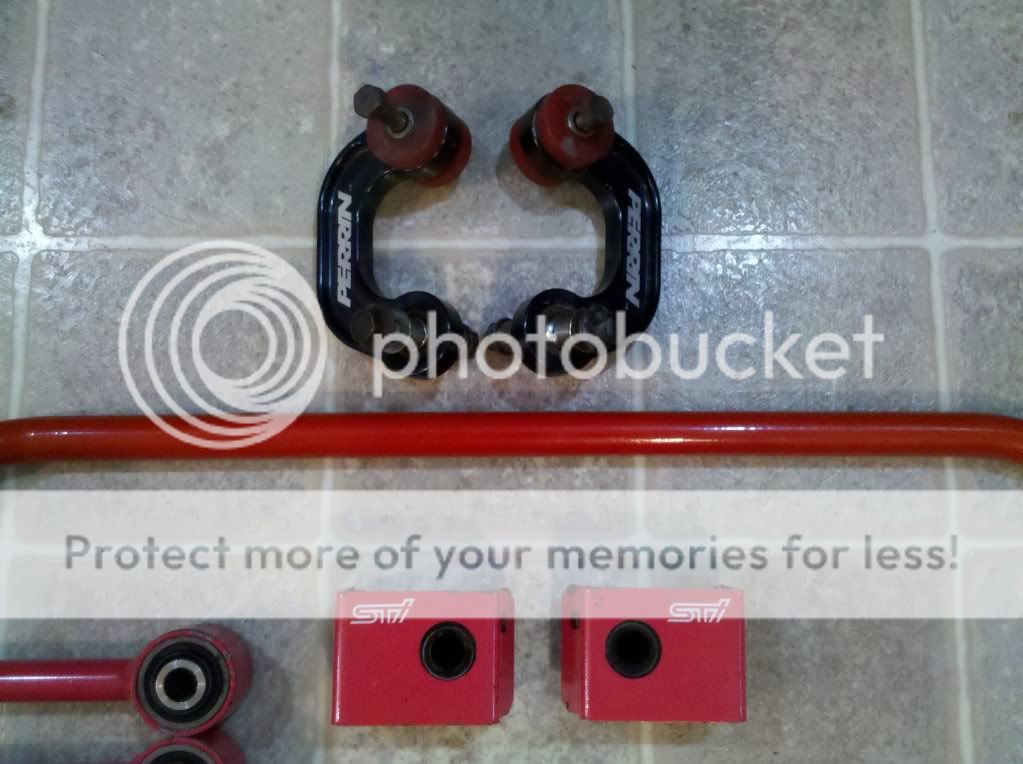

As I have come across for sale threads about lateral links I have noticed that some have a removable bracket for the sway bar endlink. Does anyone have a set of these they could take measurements from so I can see how hard making a set would be?
This would make installing a rsb in my car a lot easier then swapping out the lateral links, which requires removing the BAB.

the pink blocks is one example. Some after market companies sell them that way too.
