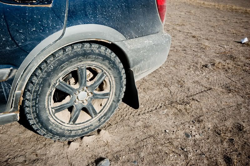

General Grabber AT-2 or Yokohama Geolandar A/T-s are both designed as on/off-road tires with blocky tread and pretty beefy sidewalls. another size to consider is stock Forester size, 215/60-16. this is still a good bit larger diameter than stock wrx 205/55-16, and will cause about 10% speedo error (speedo will read slow) and mess with your gearing a bit, which means you'll have to run in 4th gear a lot on 2-lane roads cuz the 2.0 WRX motor doesn't have much oomph below 3000 rpm and the larger tires effectively raise gear ratios.
the 215/65-16s GClark mentions are fine on a Outback, but are pretty tall for a WRX and would give you speedo error of about 15% and really make 5th gear only usable on highway and even then you'd be downshifting to 4th on the hills.

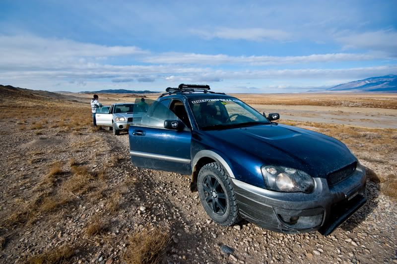

I loved mine, took me to Utah and back with plenty offroading in between.  Did throw my speedo off like Nigel said by about 4mph iirc. Quite a few members have rocked them, Nate has some on his RS currently.  Mine rubbed on my mudflaps at first, but that went away in a couple weeks...

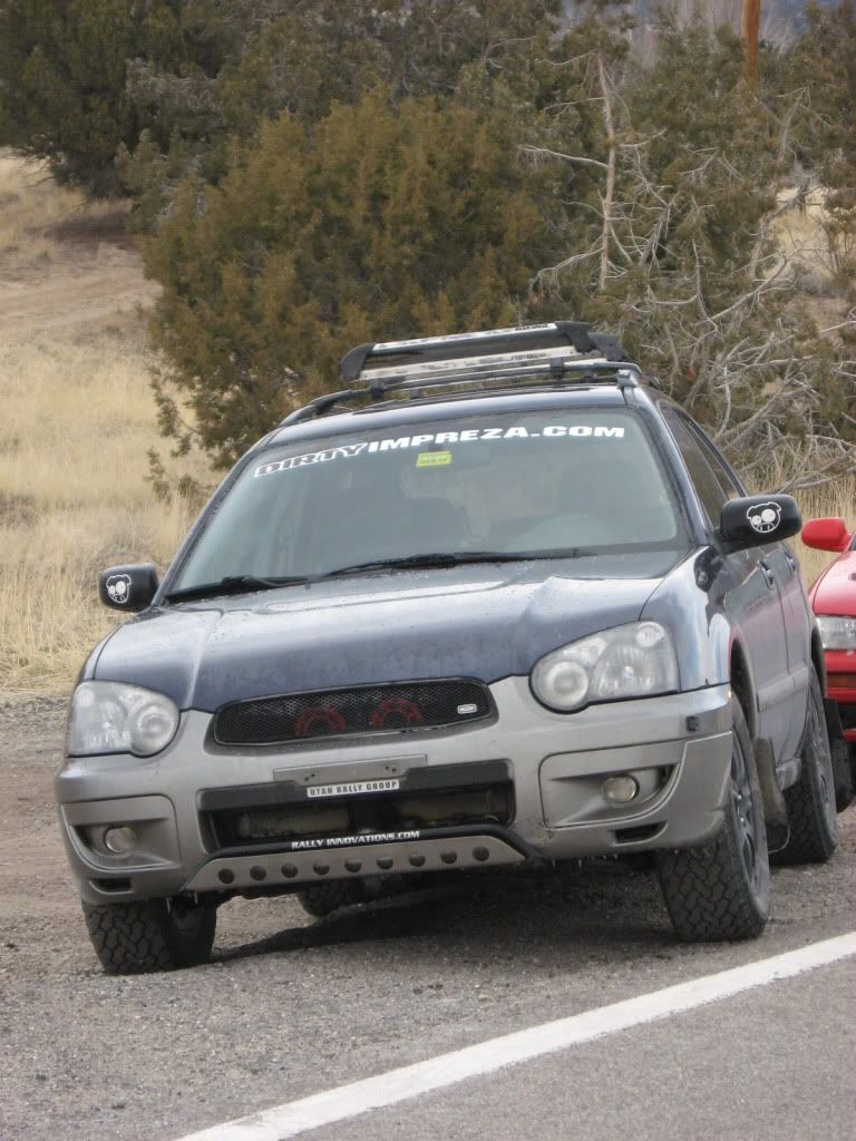

Like Clark said I have a set of grabbers on mine and I have taken it down power lines by my house with no problem. I have 215 65 16s

Ran Grabbers on the LDR recce Forester. They're tough no doubt but not invincible. Have blown a couple from hitting rocks.

On mine it only rubs on the mud flap and in the rear mine barely runner on the strut so I just let it wear lol. I know they make camber bolts to put in the rear so you can adjust it more.
