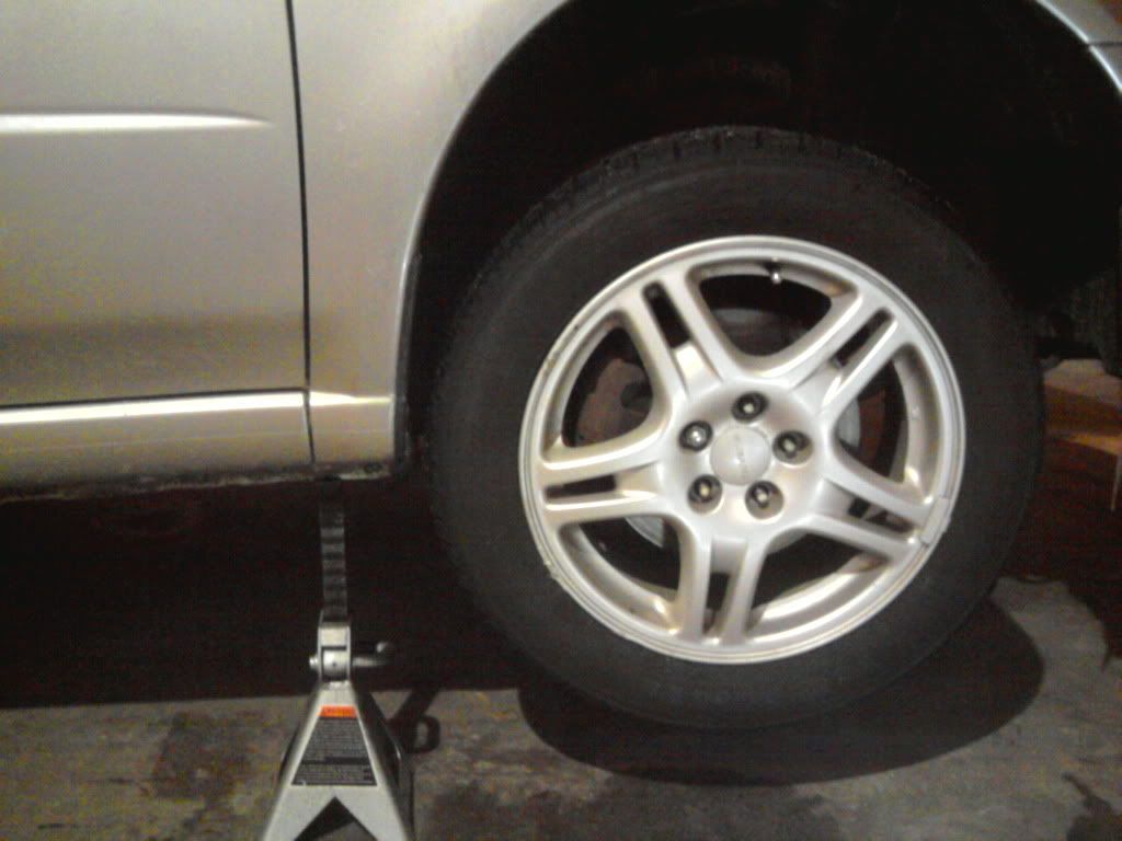

That is not how the tire is supposed to sit in the wheel well.

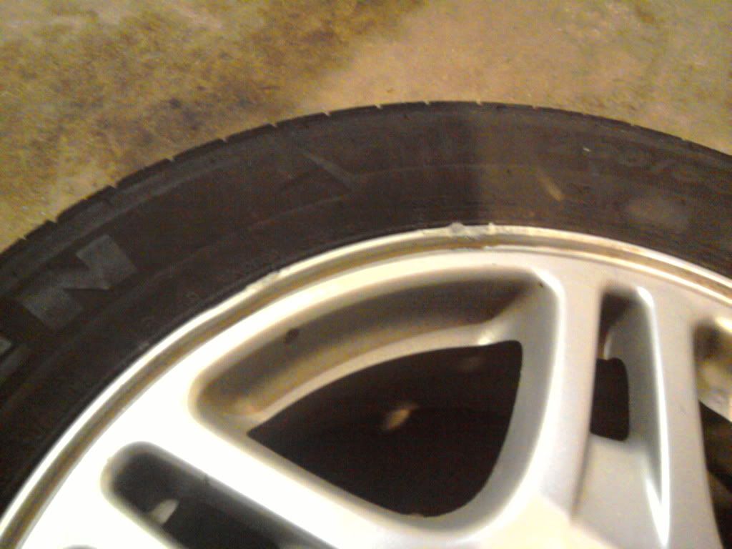

Curb rash and bent rim. Still drivable, at least it appears that way

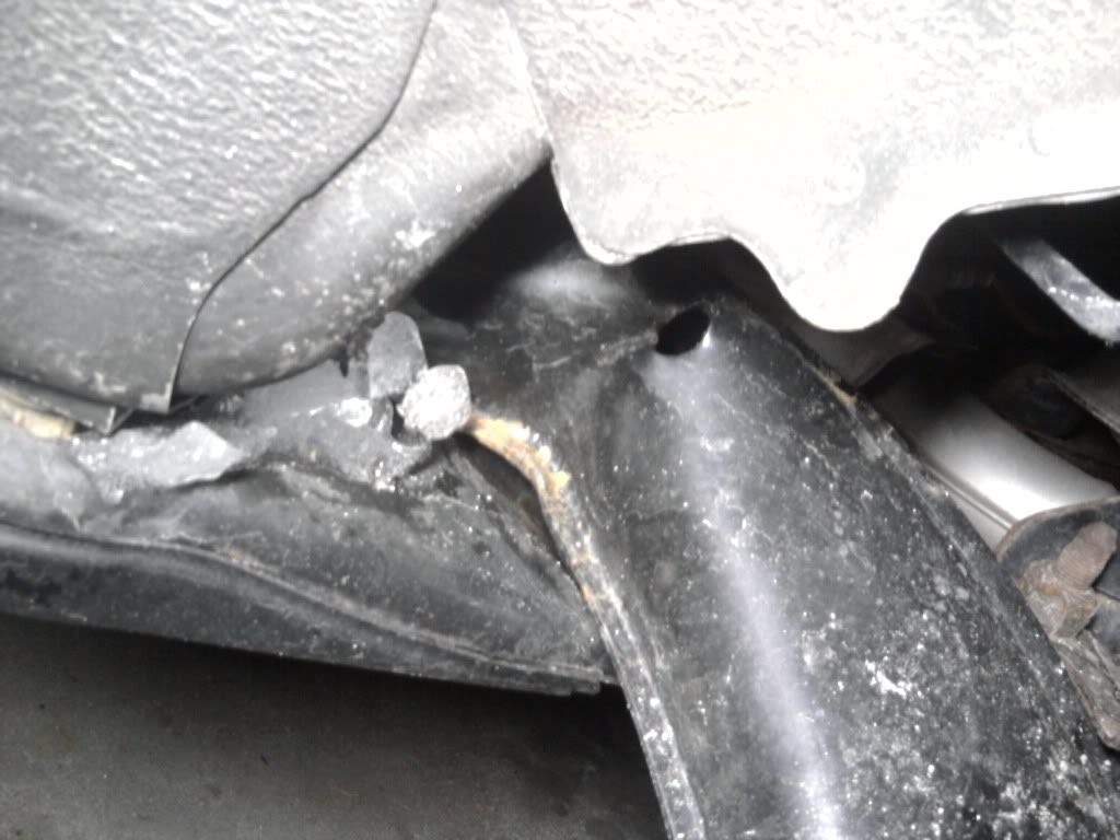

Control arm in the car, clearly bent and not pretty

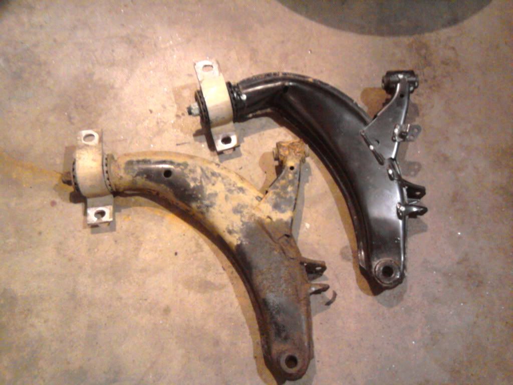

Side by side comparison between the good part and the bad part. Now, a previously stated, I have yet to take the bent arm into Patriot to see if they can do anything. I don't think a brand new control arm should bend after striking a pot hole. But, the new (used) part looks to be in good shape, just a little bit muddy.

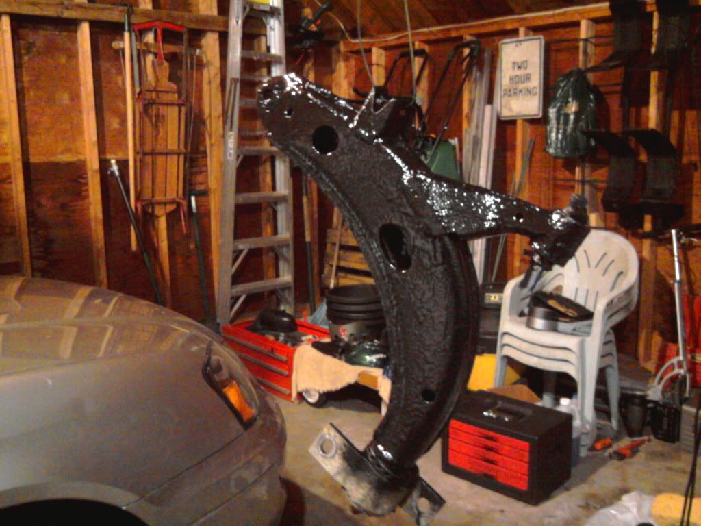

With fresh undercoat sprayed on, you cant even notice it once looked dirty.
That had to dry overnight. Ill update this when I put it back in the car. I didn't have to take much apart. Just the ball joint nut, tie rod end nut, sway bar end link, control arm side, and the bolts holding the control arm in place. No alignment needed so far!! In case there are a few wondering, I did check the strut and the strut tower for bending and they looked to be in good shape.
