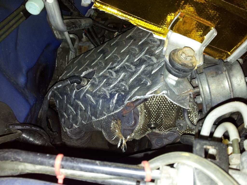

Here you can see the PTP blanket, the diamond plate aluminum heat shield and some of the gold tape work. This setup did wonders combating heat soak. I can actually use my car in stop and go traffic without the intercooler getting hot.
