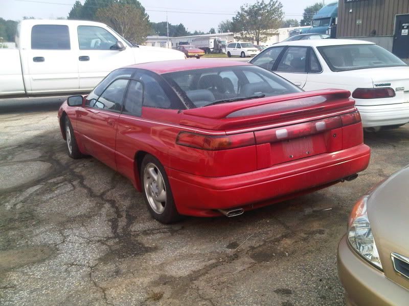

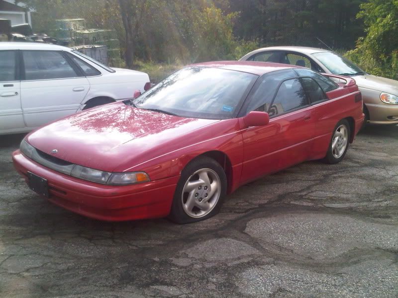

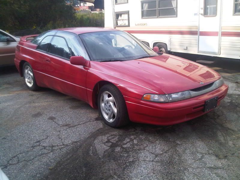

I'm the new proud owner of this 95 Brilliant Red SVX L, AWD and ABS.
Has 80,0000 miles on it and picked it up for $500!
The owner had it at a garage because all the fuses blew while hes was driving. The garage replaced the fuses and started unplugging harnesses. It started back up after the ABS module was unplugged. Then it sat for a while...
It will drive and runs well, but I am going to start with replacing the ABS module, along with the heater controls, and alternator because they were fried.
Other than that it looks pretty good, especially mechanically. It does need new struts, but there is two brand new ones in the trunk (might do Koni insert mod). All bushings look good and no rust, but it does need some new seals and gaskets here and there.
The interior is pretty dirty and is missing the sun visors, but hopefully I can get it cleaned up good.
The outside is decent. Paint is dull and has a few door dings and bumper scuffs, but nothing crazy. The worst of it is a dent along the outer edge of the drivers side fender.
I believe I am the 3rd owner. I guess the original owner (want to say his name is Jim) was a mechanic at Chip's Subaru, and sold the car because he was diagnosed with cancer. That was a little over two years ago, so I'm not sure if he is still there.
Its going to be my DD and I'm getting rid of the escort (finally). I'm not going to get into a mod frenzy though. I already have one money pit sitting in my driveway haha. But I will get into doing stuff some day I'm sure.
Here's some crappy cell phone pics for now. Ill get some better ones after I get it home and cleaned up.
