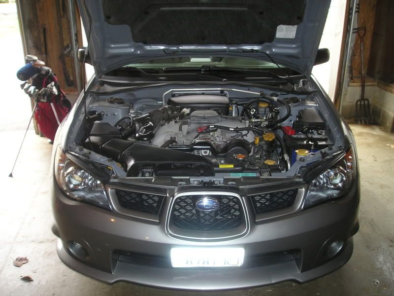

I have the OEM Subaru filter with the same Snorkus back intake set up of the WRX / STI. If it can handle 305HP than there is nothing my NA 2.5 173 hp will be an issue. See pic below. This does include the proper piece in the fender so everything is good and tight. Your stock airbox can be used. The best setup improvement is the Snorkus from the Turbo cars as it drops the intake air temps by 15+- deg compared to the stock one the 06-07 Imprezas come with. Flame away I got $20 into the used parts.
I really like these setups. Stock, they work, cheap. My legacy has one. I'd convert my RS to it too, but the whole direct dust intake on stage thing I like the obfuscated bay area intake the stock setup provides.
i-wagon
Check with Gabe. I got my replacement one from him. That setup is nicer than the factory way for the na
