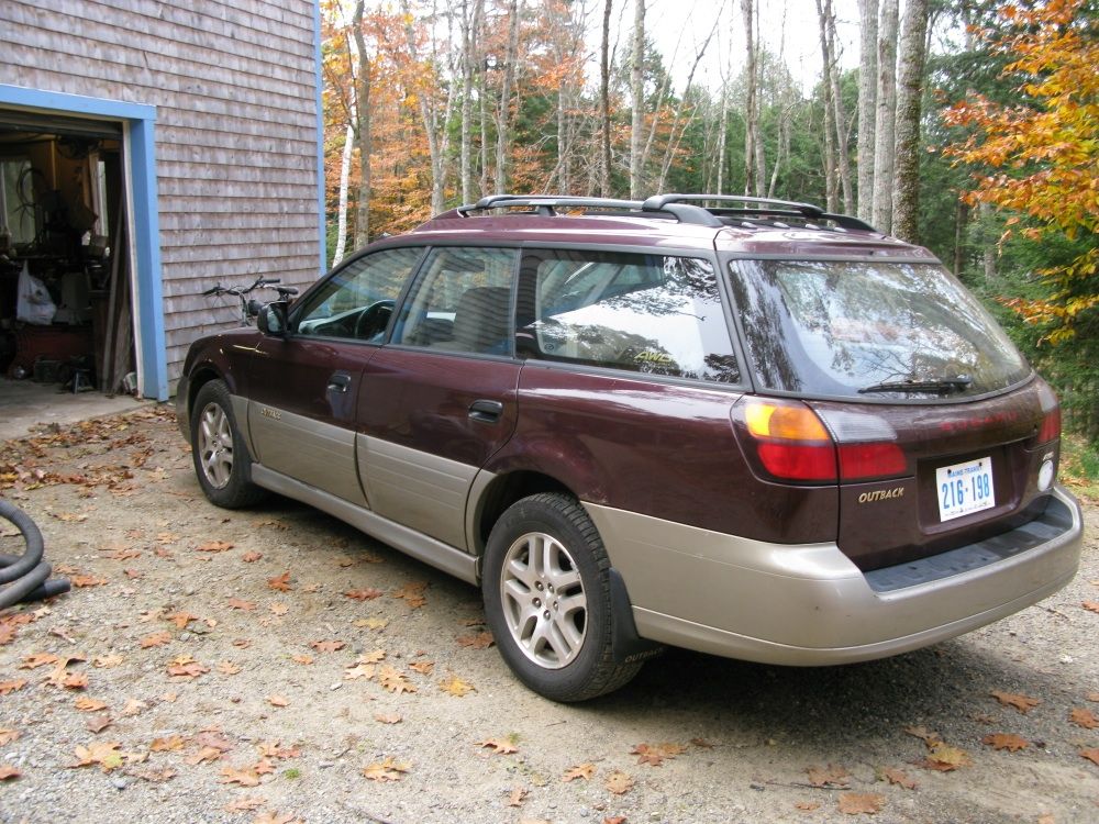

So I wanted a wagon so I could haul around all my useless crap from place to place. So I hopped on craigslist, and found this, payed $900 for it.
Picture off the craigslist ad because I'm too lazy to take my own. It's a completely stock purple car, I dunno what more there is to take a picture of.

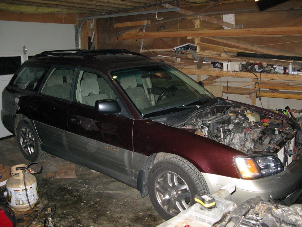

At home:

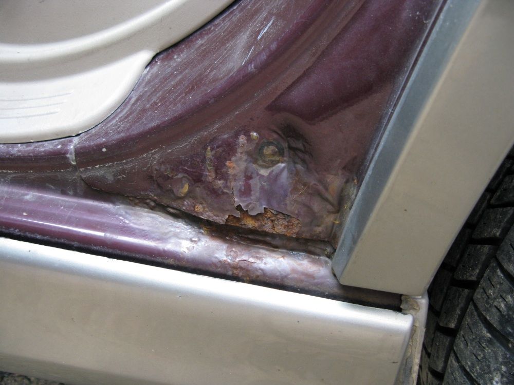

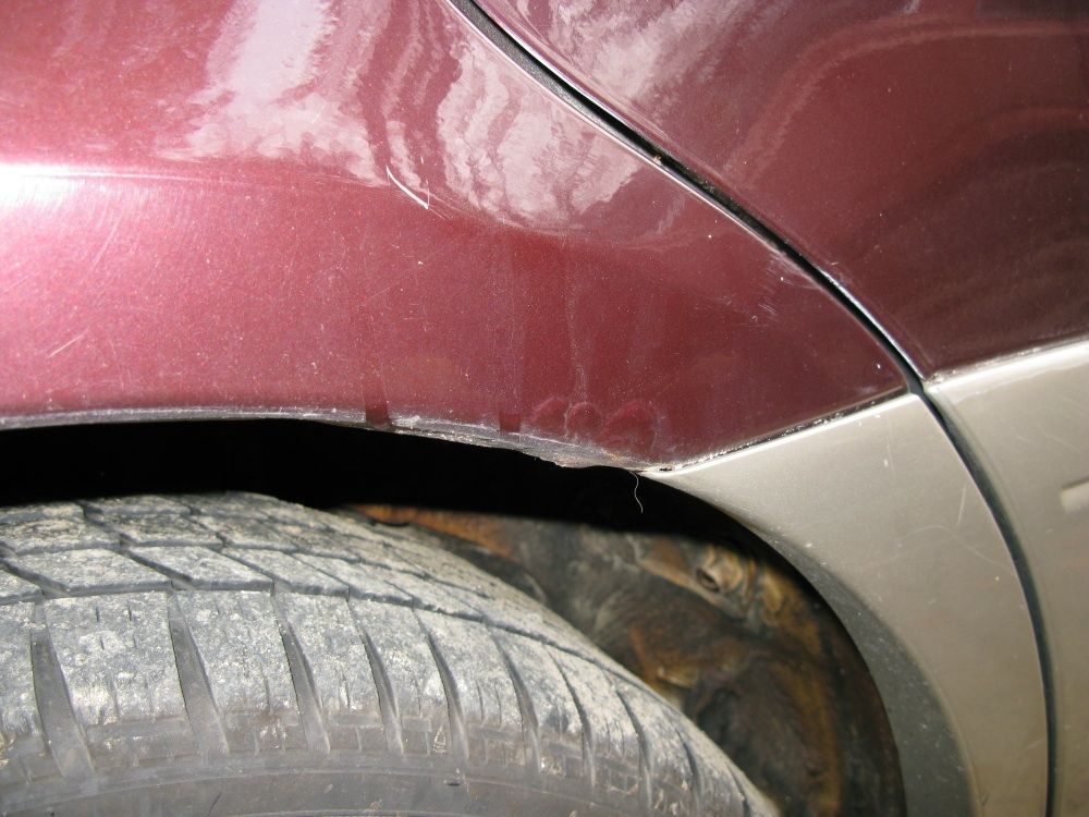

Driver's side rust:
None of it is that bad, it should be easy to fix.

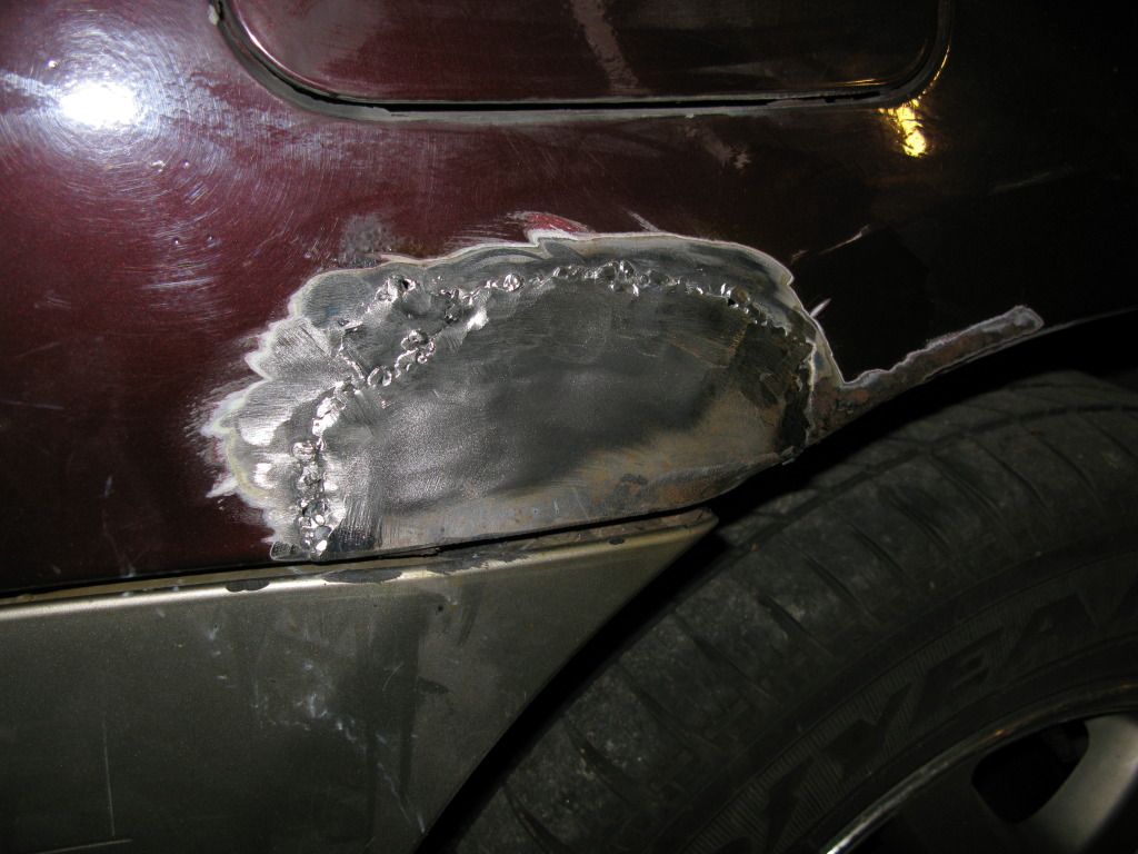

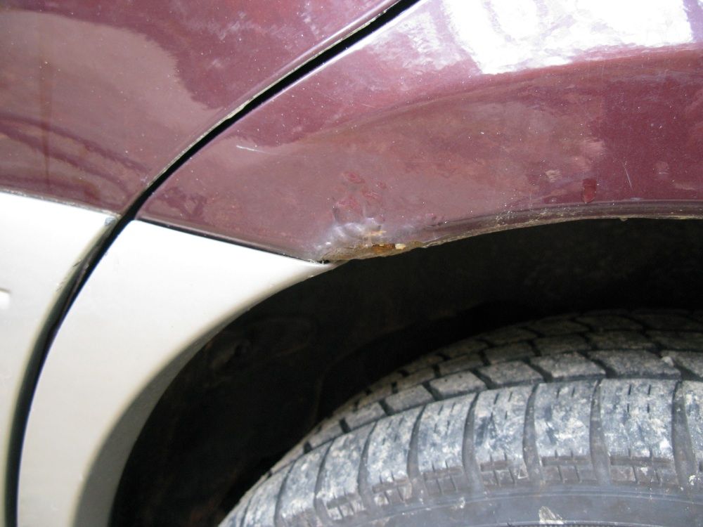

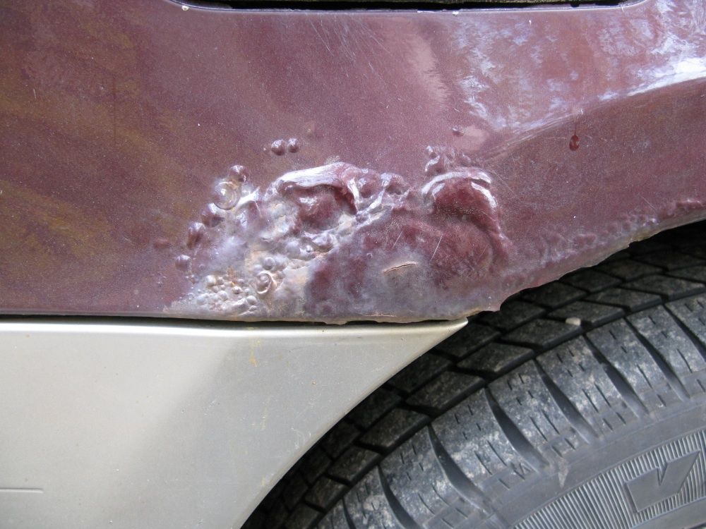

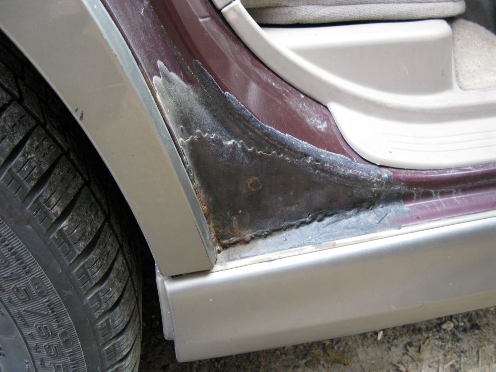

Passenger's side rust:
And same as the other side, except it's been poorly repaired here. Making more work than it otherwise would have been.

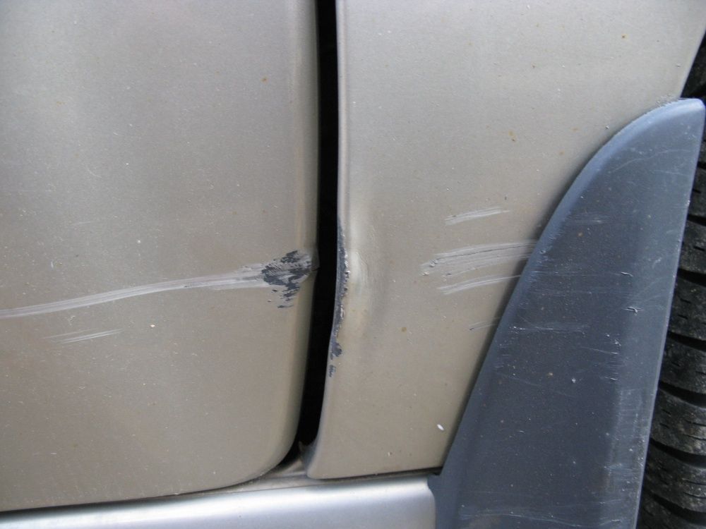

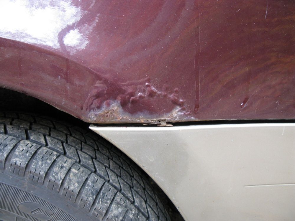

The only major ding in the body is this, between the front of the pass door and the front fender:

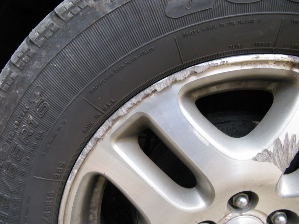

Not only did the lady who owned it before me fry the clutch and 3rd gear synchro, she liked curbs:

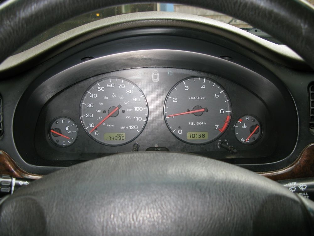

Only the light behind the second half of the speedo works. The rest are burned out. I'll probably throw some old take-out bulbs from other LED conversion projects so I can drive it at night. But ultimately it's gonna be LED.

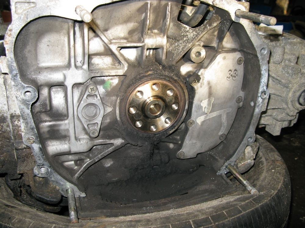

YAY IT'S OUT! It was one of the most stuck bellhousings I've ever seen. Which is odd considering the engine has been out before. There are signs all over the place I'm not the first one to take that car apart.

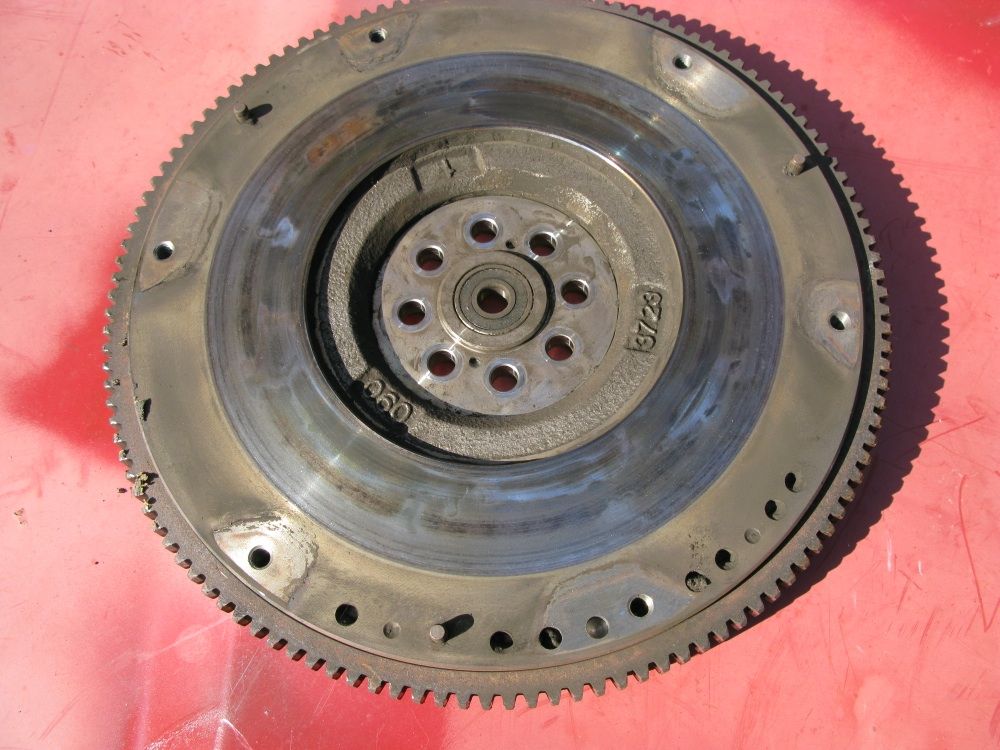

The flywheel wasn't as bad as I expected. The clutch was down to the rivets, the PP looked about the same. Oddly enough, the pilot bearing was fine, not great, but definitely serviceable. Same with the TOB. I can't imagine it's the original clutch... I've pulled apart cars with much less miles, and the bearings were totally toast.

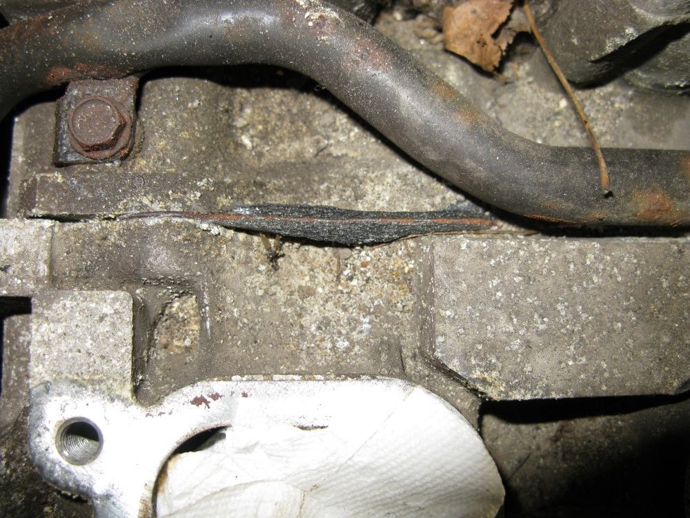

Hmm, the passenger side head gasket look ok...
The driver's side... does not
I forgot to take a picture of the head gaskets until it was after dark, since my shop is dark and dingy, I couldn't get a good pic.
But I will snap some pics of the bad gasket in the sunlight tomorrow. It's pretty blown!
I have a slight feeling the pass side has been replaced. The head came off really easily, no gasket stuck to the head or block, and the gasket looks new.
Judging by the outside view I sorta expected that. The other side was REALLY stuck, and a huge mess that needs cleaned up.

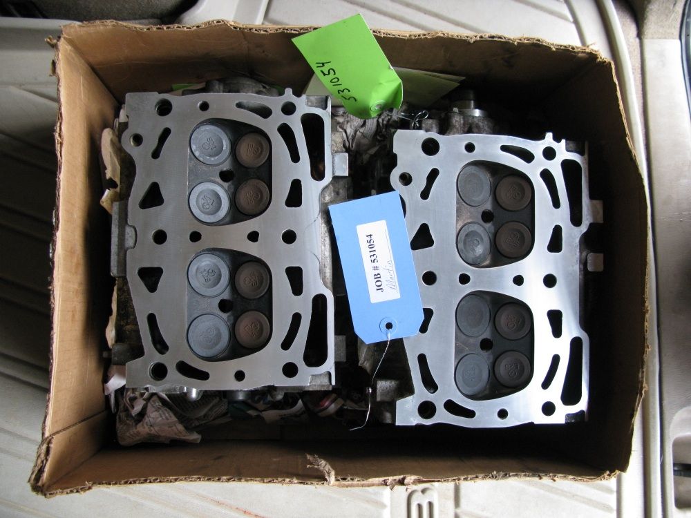

Heads are in a box ready to go to machine shop on Monday. Yes, I could do it myself. But I want this car done 100%, so I'm having a shop surface them so they'll be perfect. The valves and everything look good, inside the engine is clean. Cyl walls are smooth with great cross-hatching and no scores. Pistons are somewhat clean. A bit more dirty on the side with the screwed up timing.

I repaired some rust. I really hate welding thin japanese sheet metal. It pisses me off.
It's now coated in a few coats of chassis saver. Nice and thick, an it's hard to tell I buggerwelded it unless you get up close.
Also, I got something exciting back from the machine shop!!!

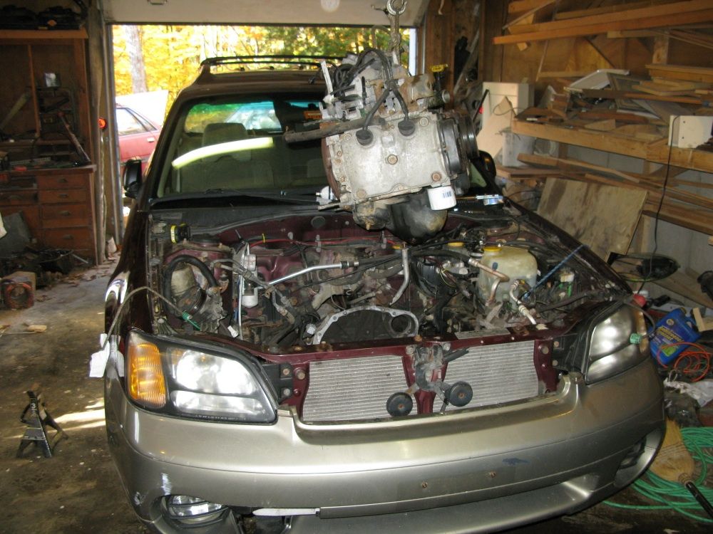

Well, engine is in, it runs and drives!!! I had fuel rail issues that wasted a bunch of money and 4 hours of time, but I got it all sorted out. I'll updated with pictures and stuff later (tomorrow after I clean up the mess in my garage).

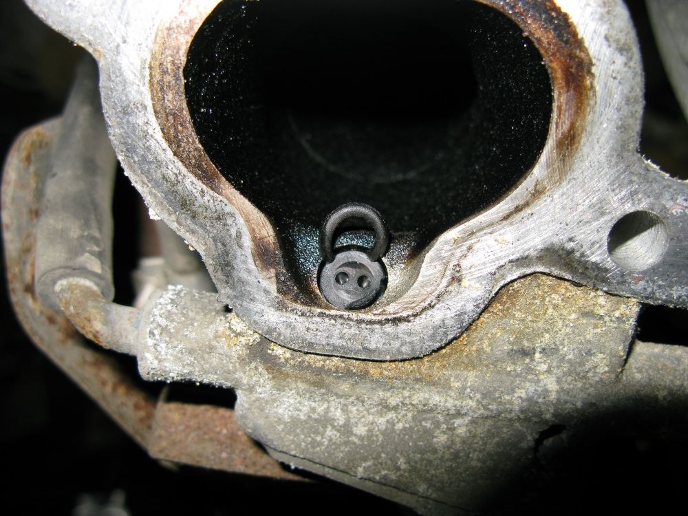

Fuel rail issue....

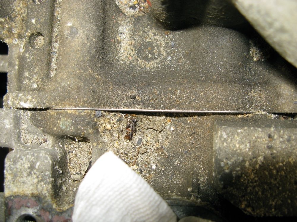

So I had the longblock assembled except bolting on the intake. I flipped it over to clean off the mating surface, and saw this :|
It really kinda ruined my day for a little while. It meant a 45 minute drive to Norm's, and $25 for another one. Yes, I know there are cheaper routes, but I wanted it done NOW.
I cleaned everything up, and put it all together. After everything was in the car, turn the key, and hear a weird noise... The weird noise was fuel spraying out of the fuel rail. At this point, I should mention that when I took one of the fuel rail bolts out, it took the threads with it. So I had to source a longer bolt so it could grab some un-used threads. That's another part of this that wasted my time...
It turned out that when I put the fuel rail back together, one of the top o-rings was a bit hard, and crunched out of shape when I put it together. Just friggin' fantastic. It was 4.50, I couldn't make it to napa in time. I figured out I still had a bunch of o-rings from an AC job, one of those worked. YAY.
I once again turned on the key with the intention of cranking with no ignition until the oil light went out. The oil light was already out. It took me another 20 minutes to track down the wiring issue.
In the end, it fired up right away and runs really smooth. It ran with a really loppy idle before and misfires. That would be due, in part, to the pictured injector. The driver's side cam being a tooth retarded, and a plug missing the electrode...

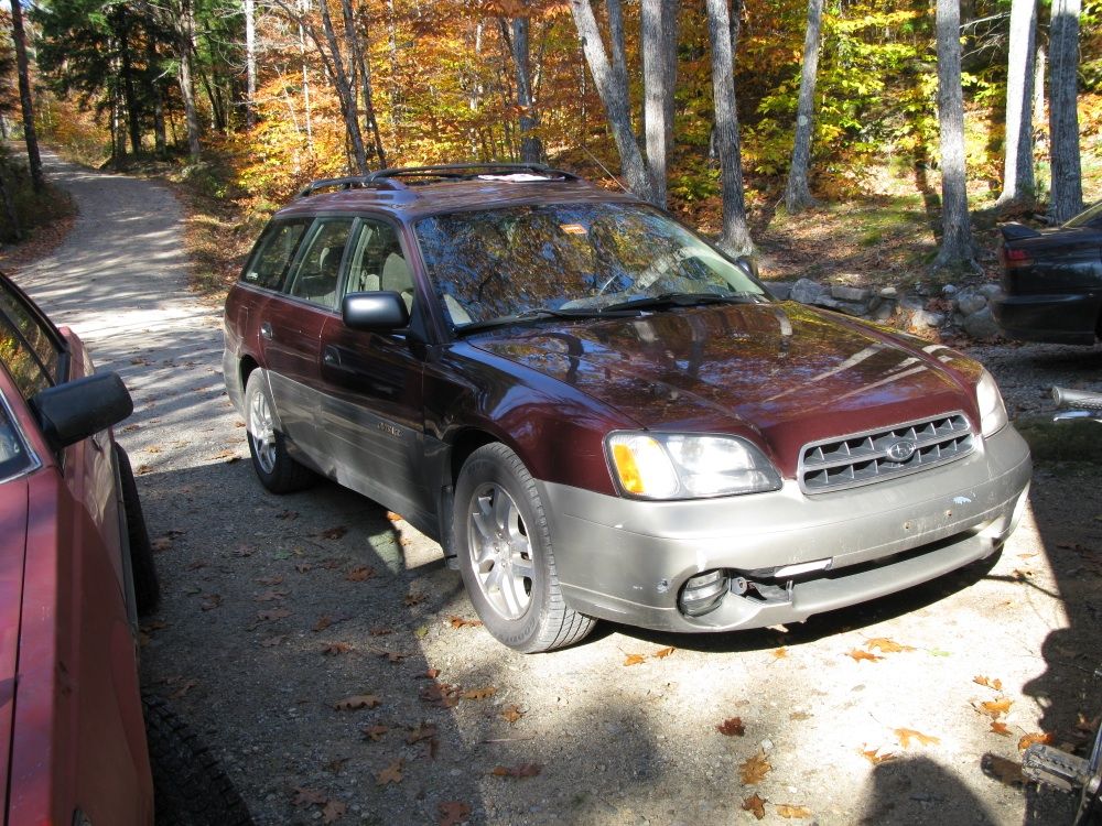

Here's how the car sits now. Just needs the RR wheel bearing done (I have the parts), and the hood bolted one. It should be sorted by the end of tomorrow
