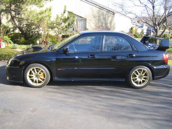

So lately I've been doing a lot of research on different springs/coilovers for my 05 WRX. This is something I'm planning on doing come spring/summer. My suspension is currently stock/monster truck status haha. Basically my goals are as follows:
NOT looking for a huge or slammed drop. I want to even out the wheel gap with a modest drop but still improving performance if possible.
Something that looks like this:
If I get springs I would still like to be able to use my stock struts. I know that limits me to what I want to do. Some springs I've been looking into are the Mach V springs (leaning the most toward these because of great reviews), Eibach pro kit, and Epic Engineering springs. I know those might not go quite as low as I would like, but they cost much less than coils and might be the best in my case
What I like about the thought of coilovers is the fact that they are obviously adjustable. The thing is, it seems DECENT coilovers are over $1000, which is a little more than what I want to spend. Seems like BC br coils are one of the best for the money. Also read about Racelands which seem to lower the car a lot for dirt cheap, but have seem some terrible reviews and experiences reading online. Any first hand experiences on these brands?
