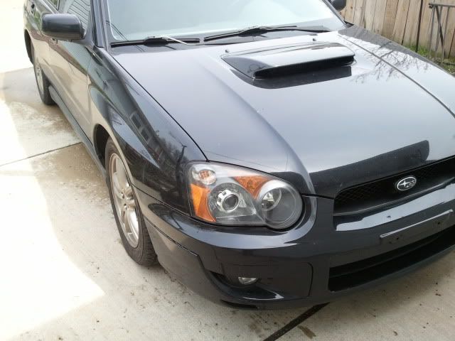

Hey guys, I was wondering what are the headlight options I have, (aftermarket) for a 2004 impreza.  I've searched and really have found nothing... any help would be appreciated!
scubiecraig
Contact Apkarian100 here on the forums.  He does custom installs.  He's done some angel eyes/audi strips in cars here on the forum.  Great guy to deal with, and excellent work.  I have audi style LED's in my headlights.  He also paints the inside housings if you choose.  I did mine black, like a lot of other people.

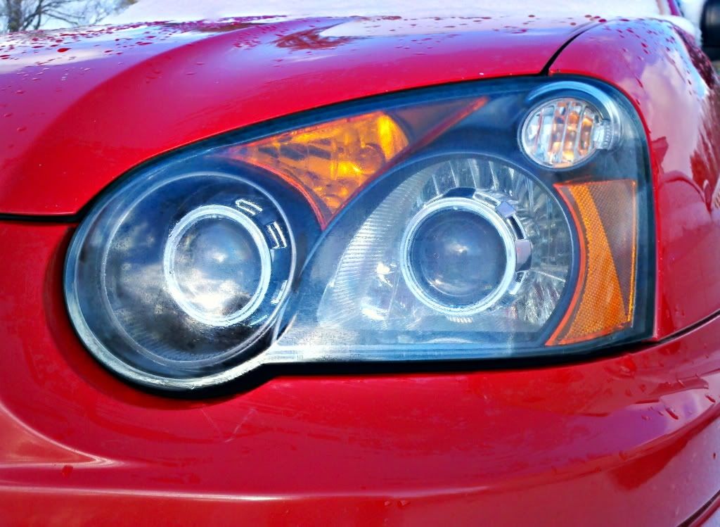

example of single mini retro:
Apkarian (Chris) does great work
