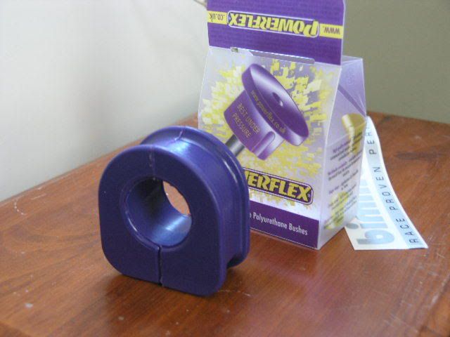

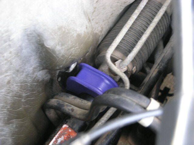

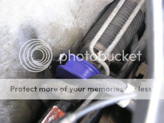

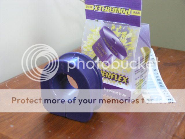

Got a shiny new bushing to get rid of the slop in the steering rack on my 900. Didn't want to pony up the $200 for the aluminum rack brace. Installation should only take about 20mins or so since there are only two bolts and you don't need an alignment afterwards and the bolts are easy to get to.

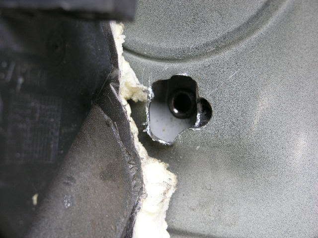

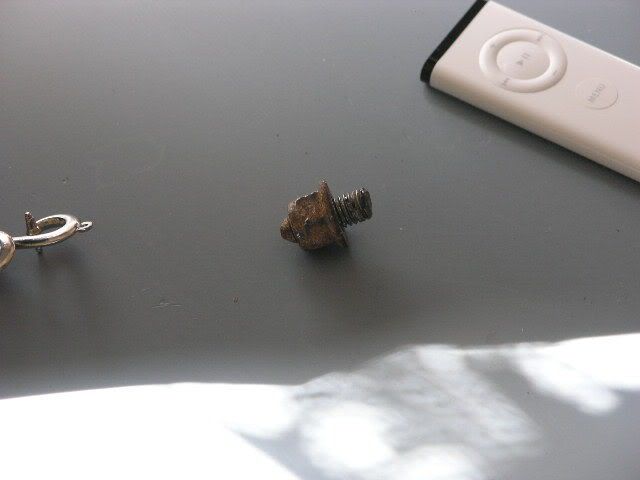

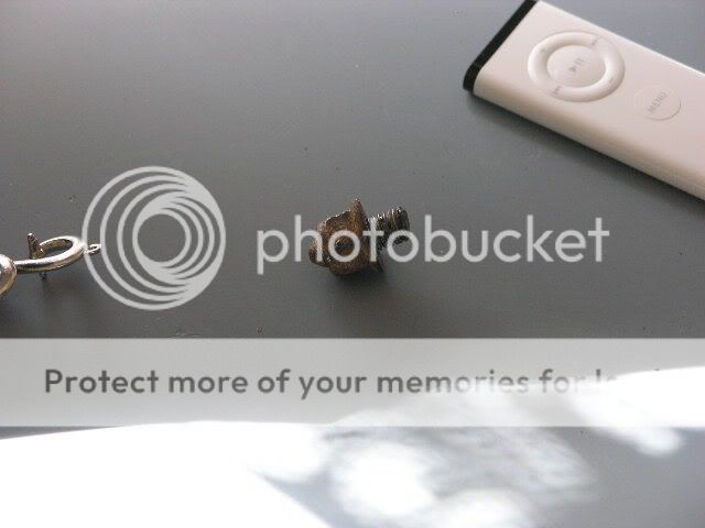

One of the bolts, correction pressed stud in a can't even get to it with a right angle drill, broke

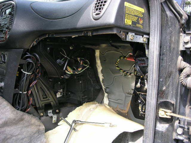

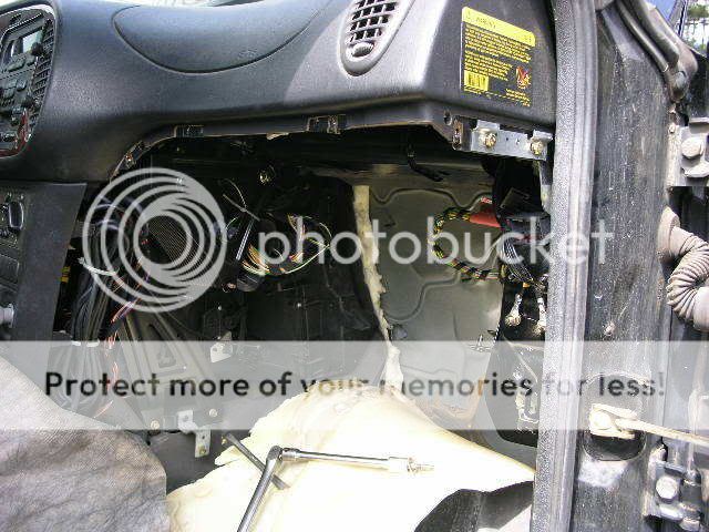

Had to go in from the back

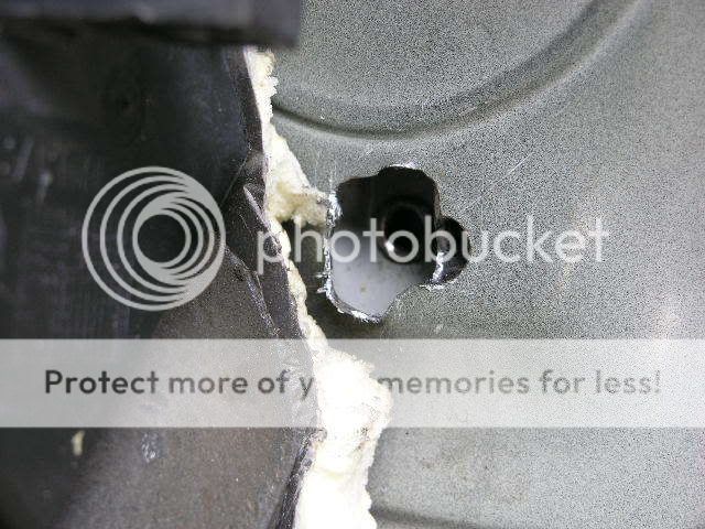

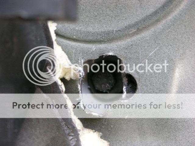

Got it drilled out with the POS black and decker drill set I have. Take a look at where the hole is though, here is the lucky part, had the mount been an inch towards the drivers side it would have been behind the heater box!!

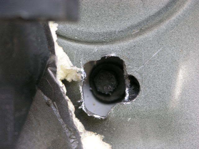

new bolt in:
Hurray!
