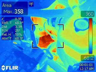

the piece of exposed turbo shows you the temperature of the turbocharger. the downpipe temperature stays consistant and slowly decreases as you move away from the turbo.
This image shows the extended idle temps (15 min after operating temperature has been reached.)
This image shows the wrapped downpipe temperature difference, when exposed to the same conditions.
358F-312F=46F
here is the turbocharger temperature after being driving normally with no aggressive boost conditions.
downpipe temps exposed to the same conditions
