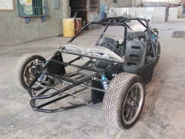

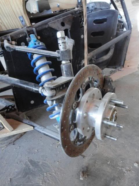

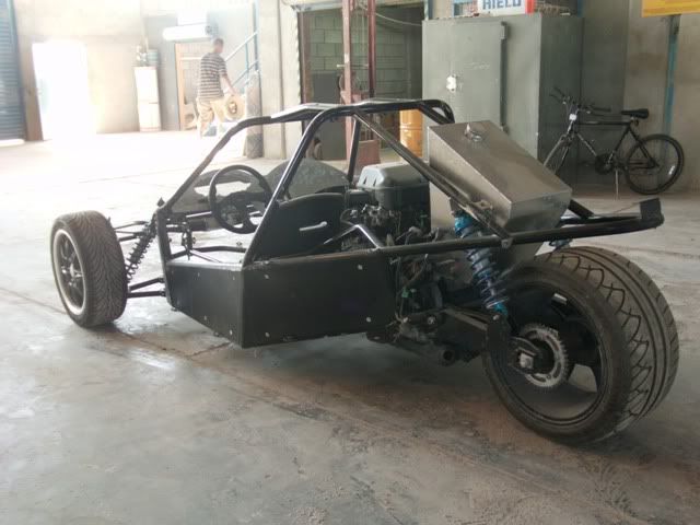

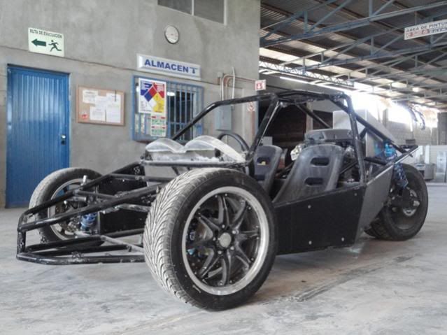

This is pretty similar to what I want to be doing...just with a Subaru engine
and a few other changes.
So here are some pictures of what I hope mine will look like eventually.
