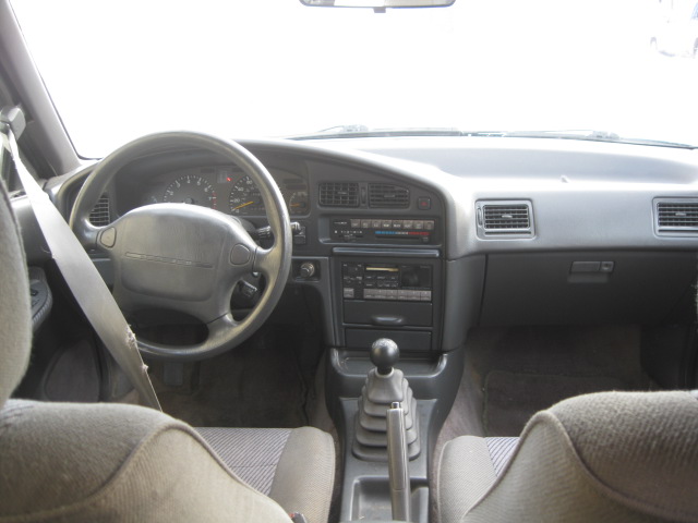

OOOH! that is a cool shift knob. didn't notice that before. I'd buy one assuming it would fit the GL!
Legwagon
BC-BF-*BJ*
thanks Nigel, SurlyOBS(thanks for reading all 6!!)
Gclark, and Chris!!
as for you two.... I know my Knob OWNZ
