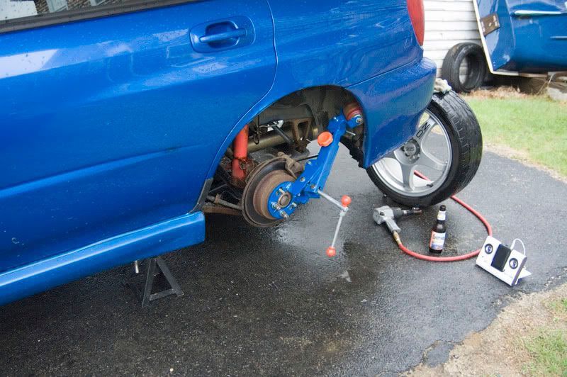

your only choice if you dont want to rub at all is rolling the fenders. you may be able to get away with just folding up the inner lip, that'll gain you another ~1/2". if that's not enough you can pull the fenders with a baseball bat, or one of these like i did:

best solution: rolling/pulling fender.
