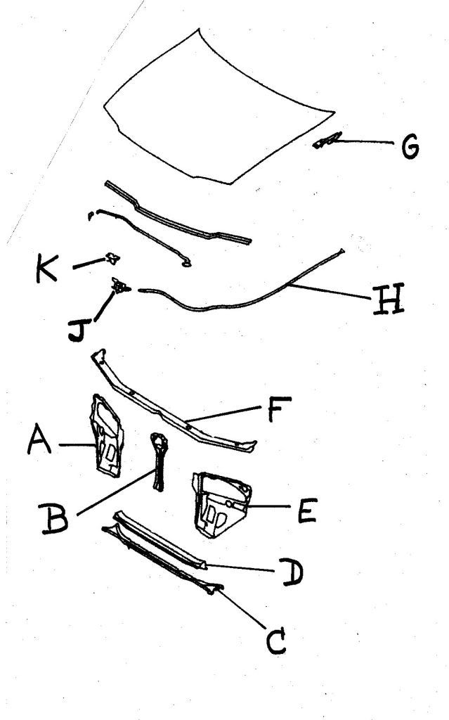

well i hit a deer with the suby. So ive decided to replace what was damaged due to insurance reasons. the parts it seems that i need are F,A,E on the picture posted.so i was wondering what exactly it was going to take to replace these parts along with the hood.

parts costs will be minor compared to labor
the rad support and headlight buckets are relatively cheap, but the whole nose of the car has to come apart to replace em. after we crashed the rally car into a tree, it took many hours of drilling out spot welds and welding new stuff back in, paint, add'l straightening (there's alsways more bent stuff than you think at first) and then reassembly
but if insurance is paying, just have them take car of it
