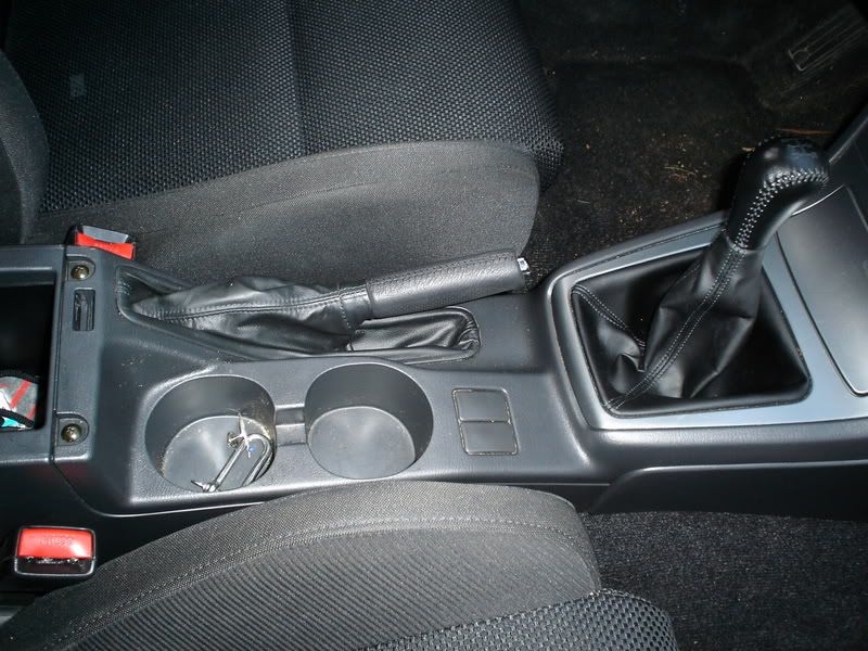

removing center console...'05 wrx
I can do it but it would be impossible for me to tell someone how to do it. If you post a picture I can circle things and point out important stuff.
The console should have about 6 clips you need to remove. A flathead screwdriver does the trick. Just don't pry too hard, as they tend to snap with too much pressure. Tread slowly, and carefully.
Ok here are some pics...hope this helps...thanks!!!

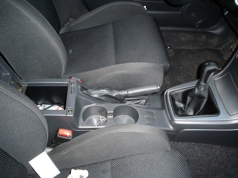

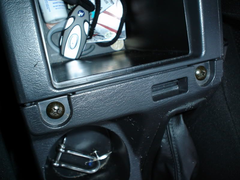

Do the 2 screw under all your crud inside the cubby hole.
Remove the 2 circled.
pop your shifter boot out by sicking a flat blade screwdriver inbetween the boot and plastic and push inwards, leave the boot on and just pull it up like a prom dress.
