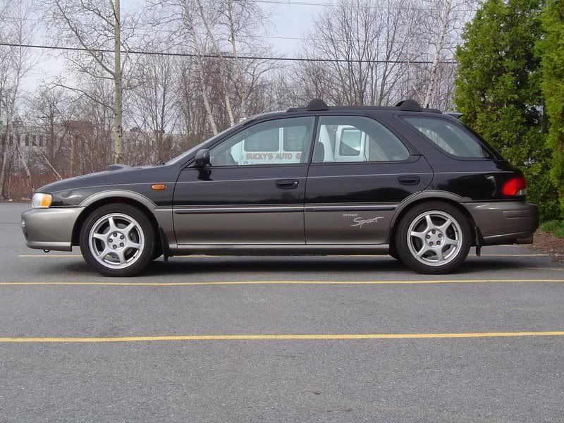

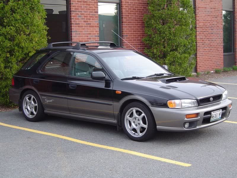

pics of obs with prodrives:
Rightseat
STI springs will "fit" but they aren't ideal. They are a lot stiffer than stock OBS, so yyou'll need stiffer dampers (shocks) and the GR-2s aren't that much stiffer than stock. If you go with GR-2s, stick with the stock springs. add good sways and you'll nitce a BIG diffrence. You'll keep a reasonalbe ride on the street whil picking up some nice gain in response. Also, rear STI springs are designed to fit on strits with slightly angled spring perches, and if you put them on GR-2s spec'ed for your car, the springs will have uneven preload which will tend to make them a bit weird.
