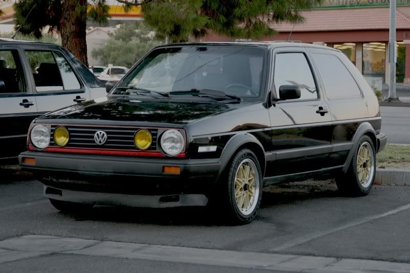

Did someone say yellow fogs? I love doing this to any car. I started doing these for my VW friends back when I lived in Vegas, it's really easy and cheap to do. The yellow Lamin-X never looks right to me, the stuff I use gives it a much better appearance.
i-wagon
What do you use?

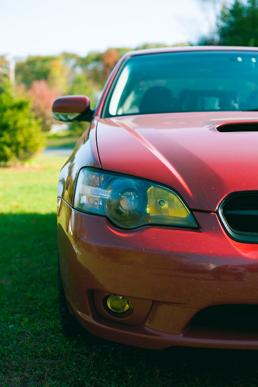

Okay, I realize I'm a little late to this thread, but I ordered some cheap yellow tint film off ebay and it doesn't have an adhesive backing. Will it just adhere with a heat gun? I want to be at least reasonably sure before I melt a bunch of yellow crap all over my  bumper.
i-wagon
no adhesive and I assume no directions? Toss it and get a can of the Duplicolor metalcast. I did my fogs and Hellas, looks good with the lights off, light output is still good and the color lit up is move
JoeBalz
2005 LGT's suck.
Directions? hah, hell no. That's probably what I'll do. I'm putting Hella 500's behind my grille in the near future and I'm trying to decide if I want to keep them clear or go yellow.
dsmith
do the duplicolor if you go yellow. or just get 3k hid's. I'm putting HID's in my hellas this weekend hopefully.
jojo69
I'm not sure if you got clarification on it (other than going with a different method), but in my experience I've done the following:
- clean/prep surface with soap and alcohol.
- Dip plastic film in warm water (you can use some Quick Detailer or soap in your water for xtra lubricity)
- Use credit card/squiggy to get rid of bubbles etc
- I've had better luck with hair gun than heat gun (too hot sometimes), but use that to spread/pull/wrap your film over.
That's generally what I've done.

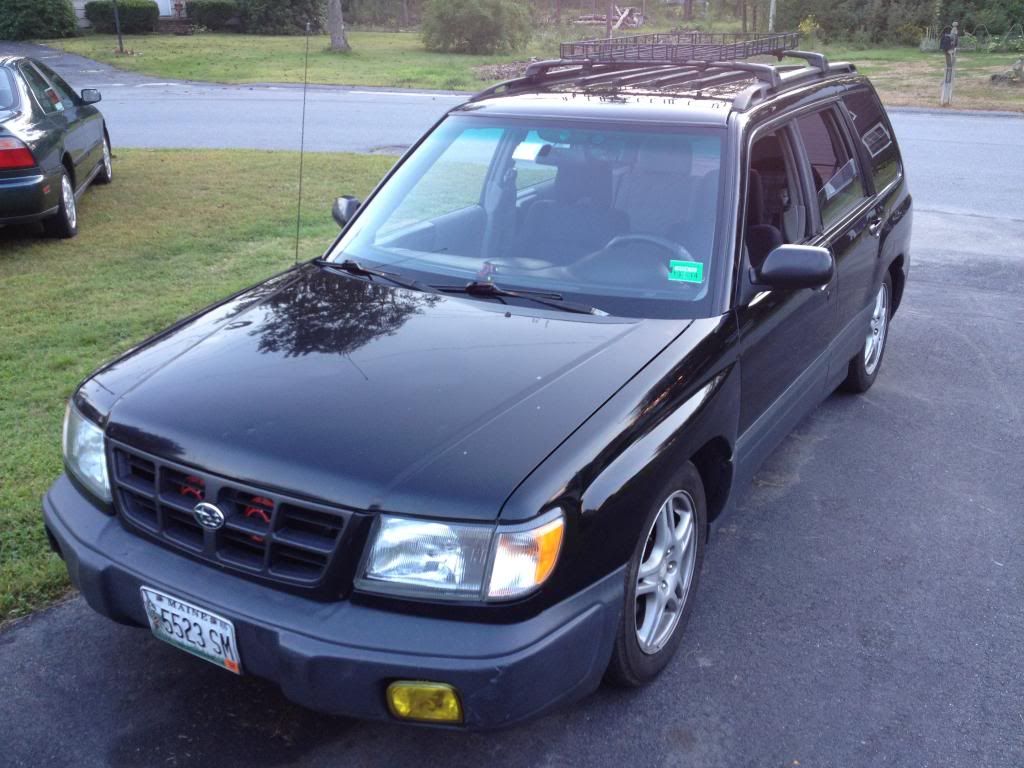

I had yellow fogs in my honda which made it look oem when not used but yellow when on, so i liked it. But for the subaru, i decided I liked the contrast of yellow & blue paint during the day, so went with yellow film. Love it. Either way, it's a fun, easy & cheap mod
good luck and whatever you decide to go with, post pics!
