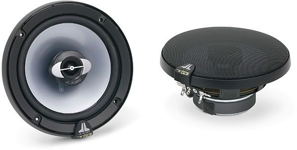

it came with some JL audios 6 1/2 already in it

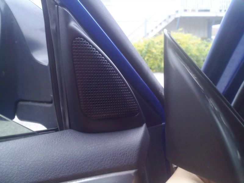

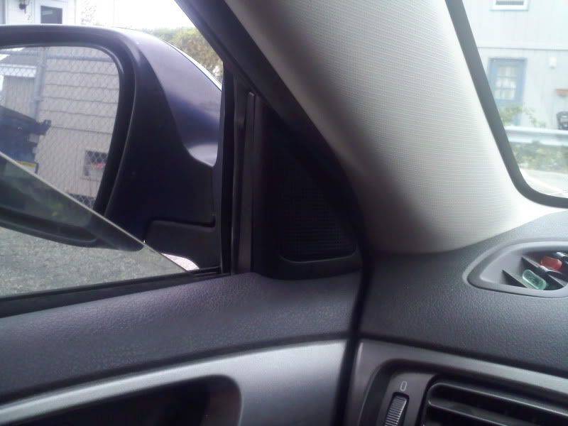

Did a "subaru premium" extra tweeter install(all the wires were ready just needed to get the grill and speakers)

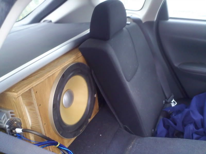

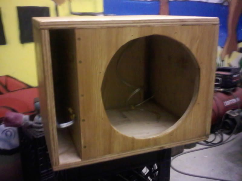

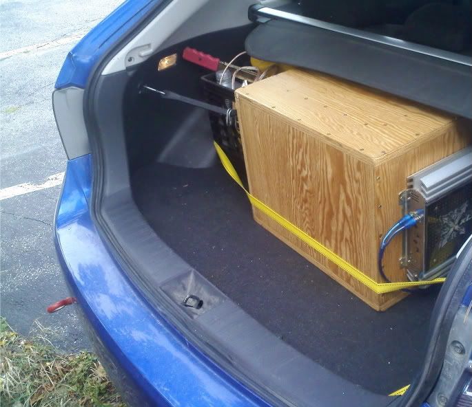

Built my own box.

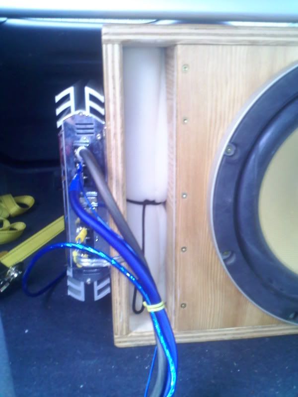

port filling in.
port filling out.

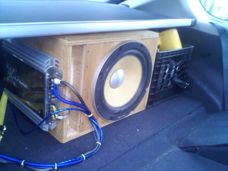

Pioneer premier 4 ohm Dual voice coil 12 inch sub

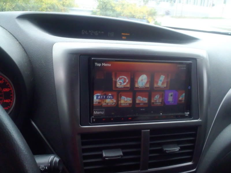

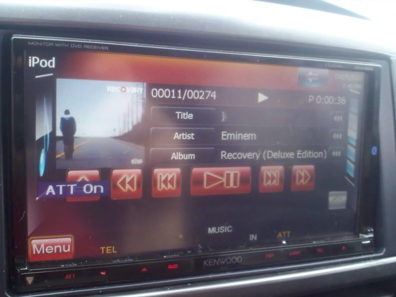

Kenwood eXcelon 2din touch w/ bluetooth, DVD, highspeed ipod, 5v Preamp sub RCA

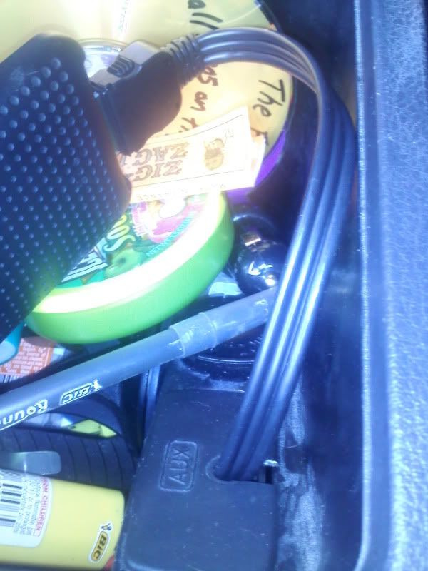

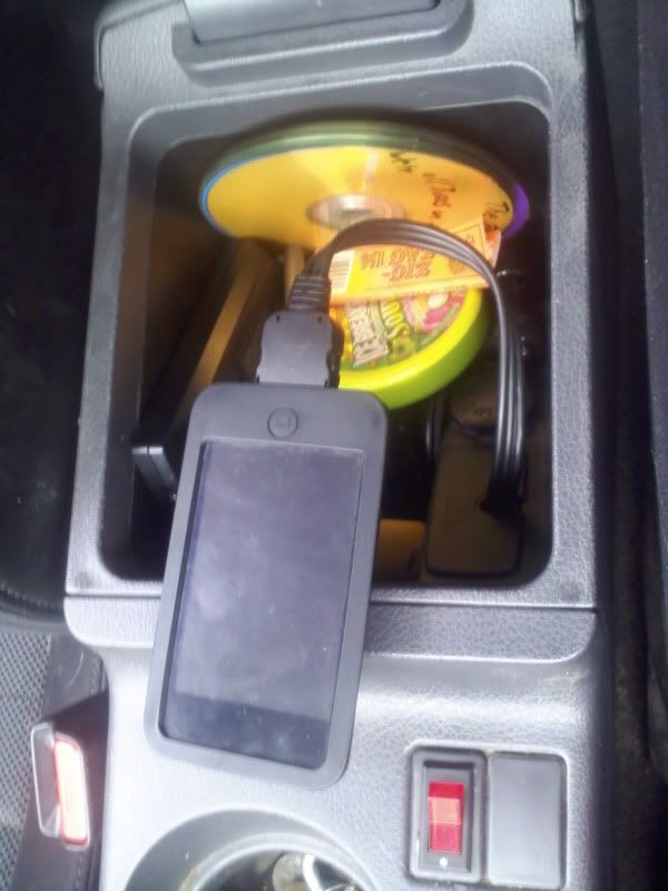

Ipod in center

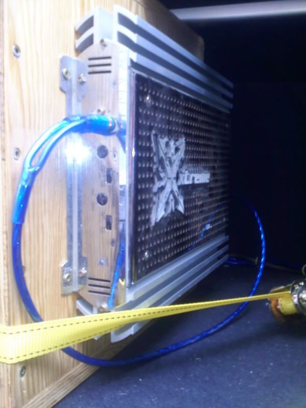

Also a Amp kill switch.

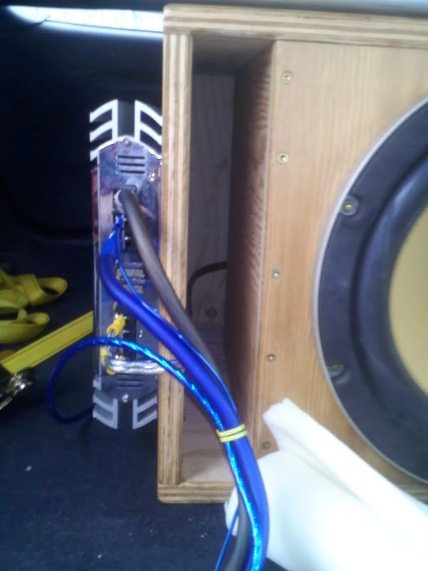

Extreme 1500 watt amp (bridged) (500 watt 2 channel rms).
not much room in the back anymore

Just a quick thought on this.The box design looks good,but I see you used what looks like 3/4" plywood for your box. Im not trying to tell you what to do,but a $30 sheet of MDF would do wonders for your sound quality,if not now,maybe a little later when the glue holding the layers together gives up. You will probably start to hear a slight "buzzing" when it starts to vibrate apart. Last,if you are thinking about covering the box,check a place called Fabric Warehouse,its over near Maine Oxy,in Auburn. they have a lot of carpet and vinyl remnants that are dirt cheap (2 or 3 bucks for enough to cover a single sub box),and you can usually find any color you might need. Ive been building systems for a little over 20 years,and this has been my secret store for most of those years. Im actually about to do an old school Rockford setup in my 04,got a couple big old power series amps,and 2 HX2 12" 4" coiled subs,with JL 5 1/4" components up front,and JL coaxials in the rear deck.Just a single DIN eclipse CD head,and a little sonic help from audiocontrol should do it...

looks cool dan...not a lot of room in the back of those things huh.....by the way....wheres the video!!!!!!!!!!
