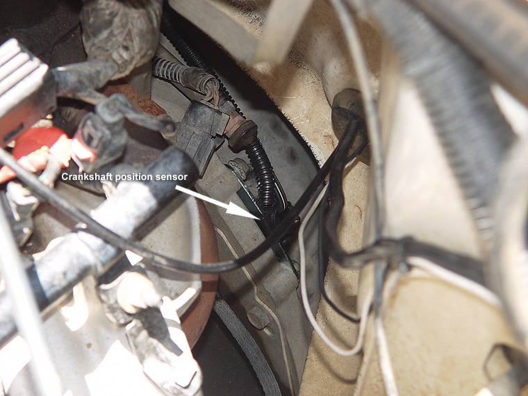

Had to get the plow Jeep running today. Local shop fixed it and it died again... Go figure.
A bunch of grounding straps broke, so I'm assuming it kept blowing out the CPS (crank position sensor).
Here's some guy's picture of where it's located:
In this picture, a ton of wiring harness ISN'T in the way. On our 95, you can't get to it from the top, and you can't get to it from the bottom (easily). I had a gigantic construction of socket wrenches, u-joints, and attachments while working under the damn thing in 15 degree weather. I finally figured out how to snake my hands up around the exhaust and driveshaft to get close to the bolts. All this was done while on my back on cardboard on top of ice. It sucked. I notched the new CPS mounts so if it blows I can remove it easier without removing the bolts completely.
Got it done and the driveway plowed.
