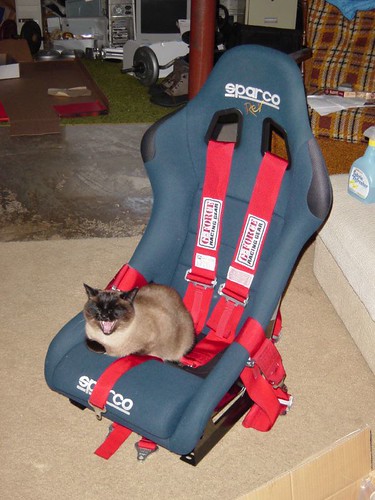

Eh, just give in and get one of these...
I can't quite remember what I spent, but I got 2 sets of geforce 6pt. camlocks and the sparco rev for something like 280 if I remember right.

and ty i would go and do that but i'm not quite ready to commit to a fixed back seat quite yet haha, i have a coupe and that would pretty much make my back seat completely unusable.

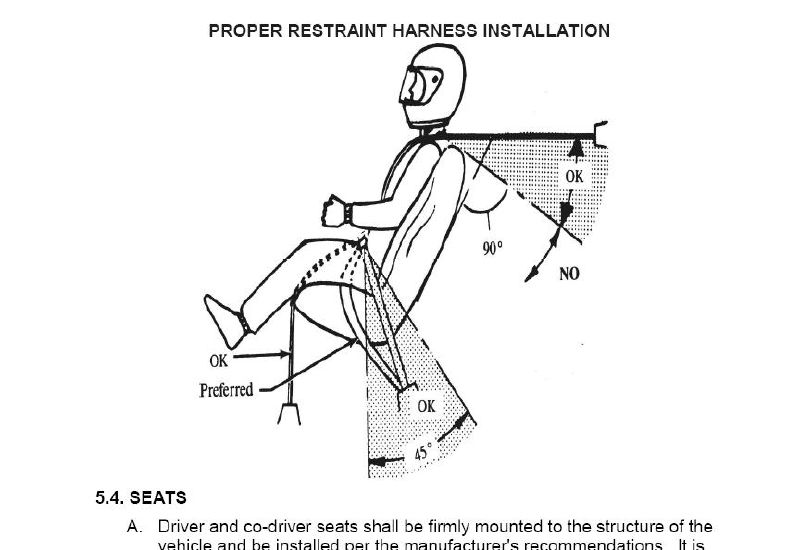

pay close attention to angle of shoulder belts. in RS coupe, using stock rear belt anchors means you have a pretty marginal angle according to the diagram posted above. that's from the Rally America rule book BTW, so it's not just somebody's vague idea of what might work. also need to be sure lap belts are tight and don't run up over your abdomen when the shoulder belts are tightened---this is a BAd combo. if lap belts are extra tight, you should OK even without a sub strap to hold lap belts down.
