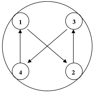

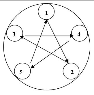

I have never used them and only had vibrations from bad tires. Just like Evan said, tighten them alternating ACROSS the tire not in a row. I ALWAYS get them snug while the tire is still in the air and then just lower it down enough so the tire will catch on the ground enough to keep from turning, not all the way down. I also do not use an impact wrench unless on steel rims. I have always tightened up lug nuts on aluminum rims with a torque wrench to 90-100 ft-lbs (depending on application).
The biggest thing is tightening them in an alternating pattern and just snug first. Don't crank the first one tight before they are all snug. Here's a pic of the tightening pattern:
