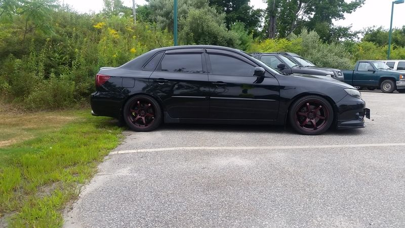

This is my inspiration........... except the wing, and add a lip:

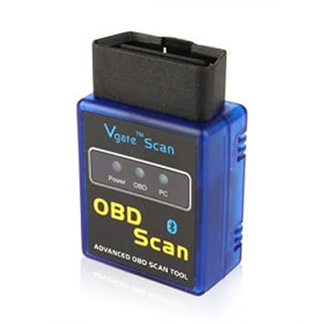

My OBD2 adapter came in the mail today. I bought the cheapest adapter I could find
but almost regretted it when I didn't get it to work. Messed with it for an hour or so and then just as I was about to give up, it worked. So I was able to find out what the codes were. No po420, but a couple others I'll have to look up and diagnose. Anyone have these before?
injulen
Just one sensor, they're all on the same one. I think that's the front.
Also, I've had two cheap OBD-2 dongles, they're the ~$10-$15 blue ones. Both have been able to read other manufacturer's ECUs instantly but struggle with Subaru. It never works first try, gotta let it sit there and think for ages.

Cool, 1 sensor is not as bad as I thought at first. I'll get on that asap.
This is the OBD2 I have:
It worked once when I got the codes, after an hour of fiddling with it. Now I can't get it to work with Torque either on this car or my WRX. It'll connect and do everything right until Torque (Pro) says something to the effect of it not being able to talk to the ECU. I emailed the seller I got it from, but I'm not holding my breath. That one you have currently looks like it's a decent one
