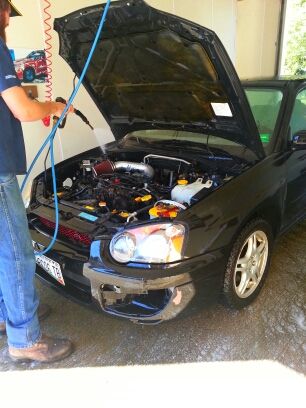

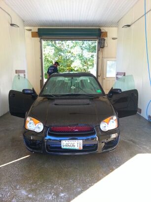

Not much to update but I got some pics from the carwash today.
Since last post I have Put on a cheap Ebay cold air with a better filter, removed my spark arrestor and resonator and replaced my muffler with a 17" glasspack which you can't see at all because I thought a friend had told me he used the shortest so I just threw it on. Plans now are to replace the 17" with a 28" and put the 17" in the midpipe somewhere.
Enjoy Pics!
All Soaped up
Still looks like raisin, Scratches and dings everywhere. Anyone interested in doing an exterior detailing job and teachin me some things?
Soon to come is stock intake because ebay one has a small leak and doesn't fit quite right, Good interior cleaning and gettin it all back together.

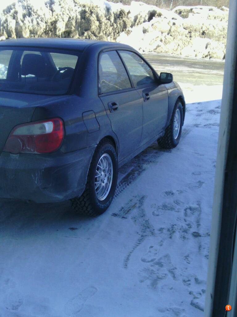

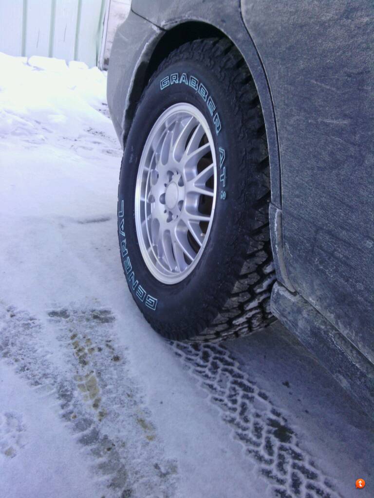

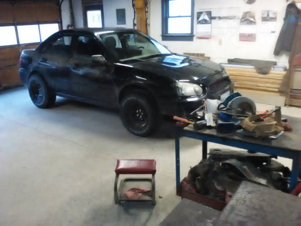

Got me some new tires and wheels! Now i need a lift...
225/70r15 Grabber AT2
On
15x6.5 +38 MB Mesh X
