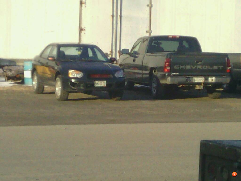

Got some 04 XT struts installed and replaced my rear brake pads over the weekend. Car rides nice but rubs the skirts pretty hard when the rear tires drop below resting position. Gonna keep the miles off it until I get an alignment which will be within the next couple weeks. Not sure if I will see the car with any daylight so pics might not be on until this weekend. 3.5 inches of total lift at the top of the wheel arch

Couple poor quality pics for you guys, hopefully I get some where to take good/action pics this weekend!
