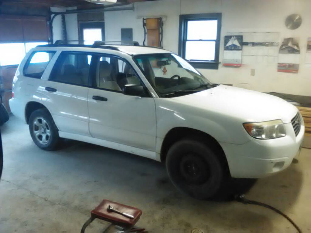

Since my Impreza is going to have to get put on light duty for a bit, the Forester is finally getting a thread and some love.I picked her up last June with 134k miles from Quirk Cars by Us. Quirk had just gotten the car and hadn't had a chance to really look it over. I checked it out and drove it around the lot for a minute and knew it was my next car lolThe exterior could use a good detailing but the inside is great and the motor and transmission feel really nice.She's a five speed and all stock apart from a cheap Kenwood head unit. I plan on lifting it with ADF lower strut brackets, tint, hitch, and getting a nice exhaust note. I've already done the timing and water pump.
I did find out it was previously owned by a local doctor whose kid must have traveled to or in Massachusetts quite a bit. I'm hoping that means I won't find any poor maintenance issues but what fun would that really be!
For toc and pics!Sent from my Z753G using Tapatalk

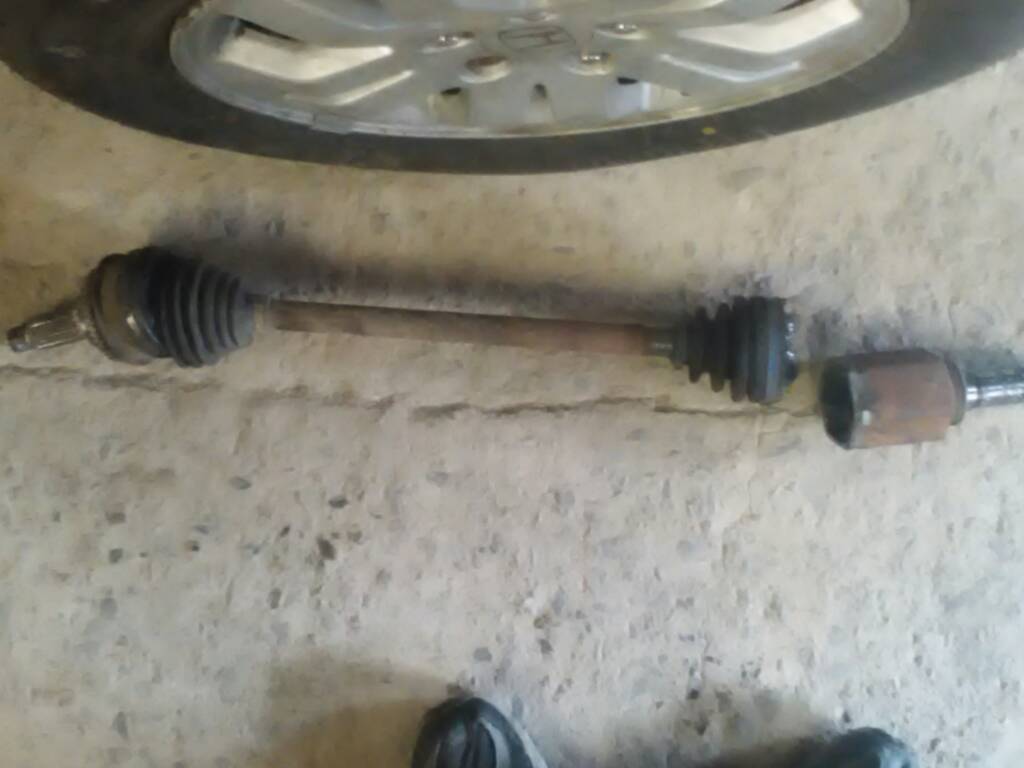

Replaced the axle today. Went with a Carquest axle from Advance Auto. No more knocking under acceleration!
The outer boot was ripped and started making noise before I got to it. The inner end came apart trying to get it out lol

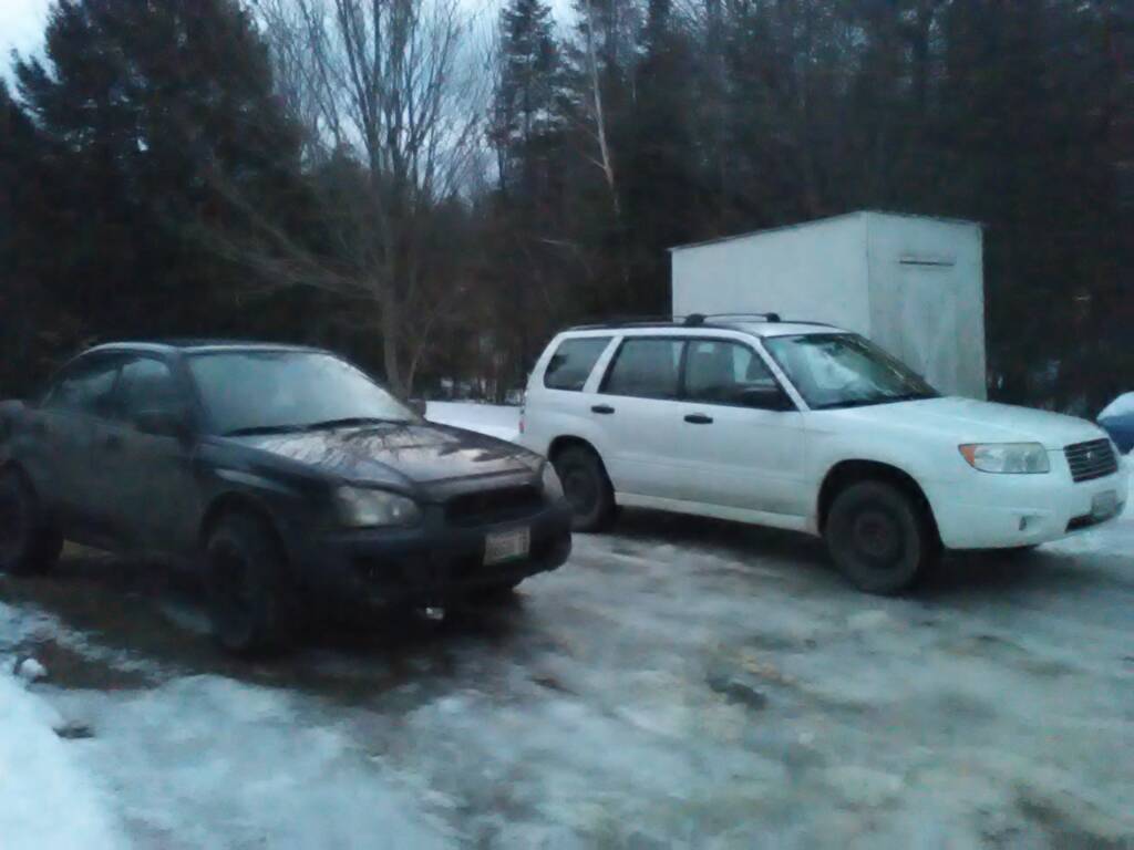

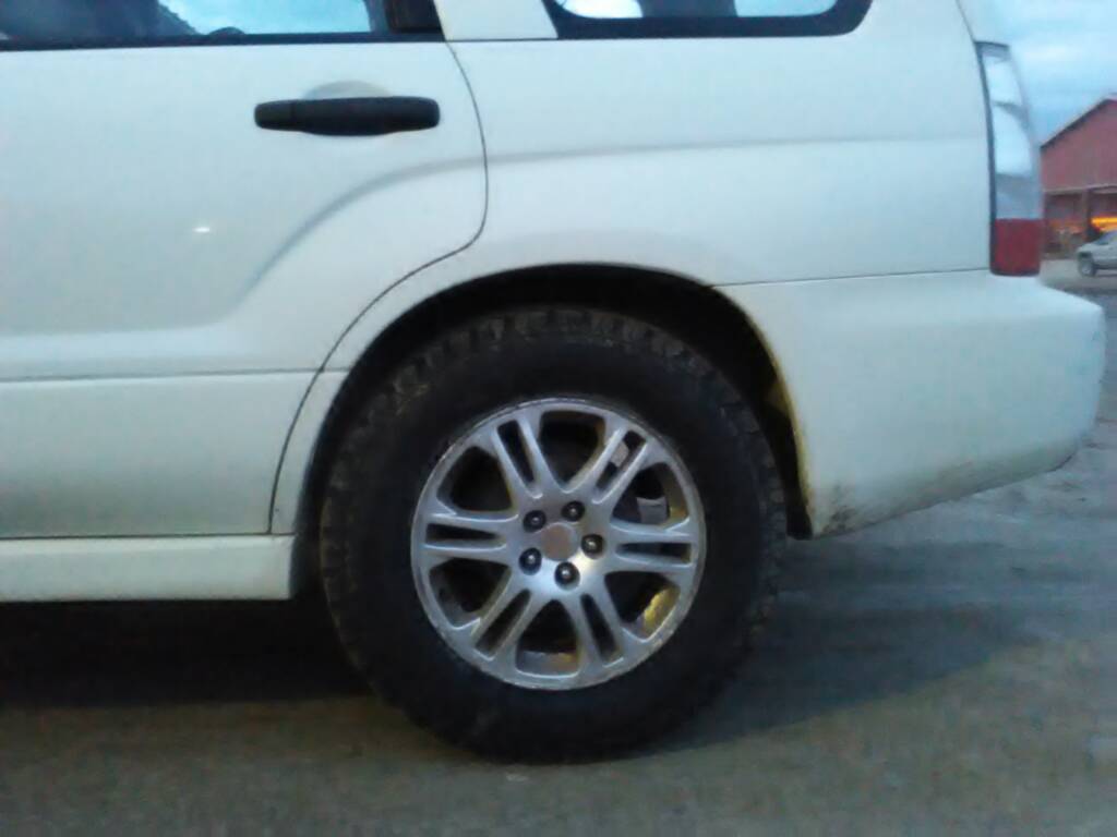

I also threw on my old blizzaks to get by this winter. Kinda hard to tell but the stock 205/60r16 is on the rear and the front is a 225/65r16 for comparison
Back to driving this daily now. My next project is to try and get rid of the wind noise in the front window seals

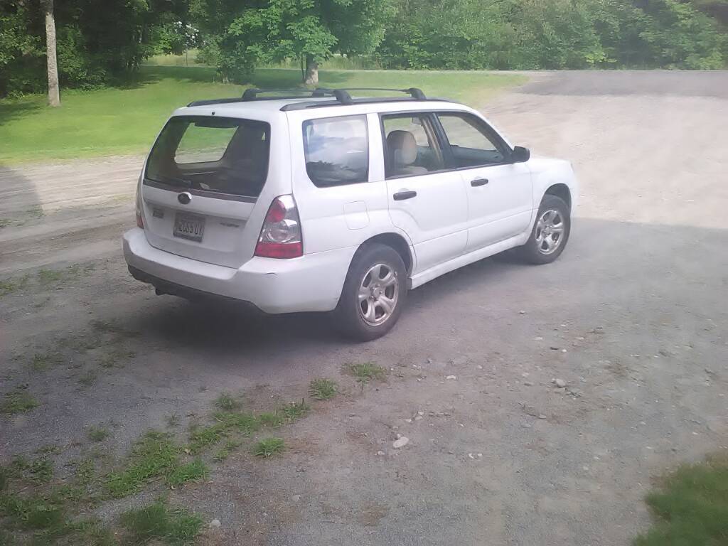

Tires are about done on here so I just ordered some 215/70r16 grabbers! Will be going on 04 XT wheels
42012RS

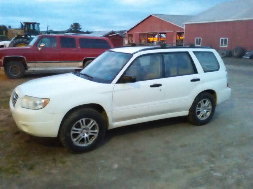

Wheels and tires are on! New tires always feel so nice. Slight rub in the back of the front wheel wells when turning as I expected. I'll try to get in for an alignment next week probably, see if all the possible caster helps. Might be the week after as my first child should be coming any time now
Wheels don't look bad with my phone camera but they're pretty nasty. Any tips on stripping them?
