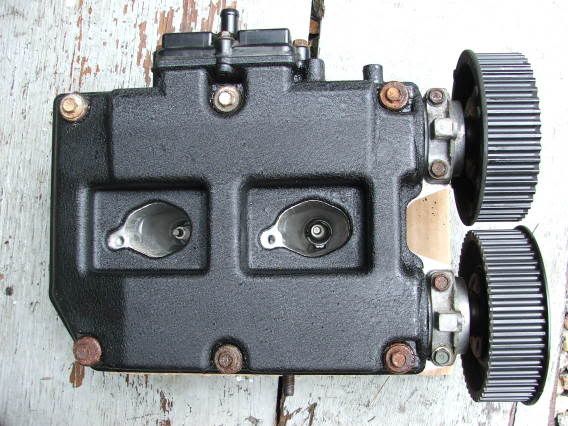

i'll be working on my car saturday, all new pads and maybe an exhaust if caperex has time to come over. i showed runnah how to do his valve cover gaskets at my last garage day and you it was pretty painless. feel free to call saturday a garage day if you want to come over. i'll make a thread if you're interested.

these are the bolts you'll be looking for, the DOHC motors like this one have 6 around the perimeter, whereas the SOHC motors have ones in the middle as well. once you take those off the cover basically falls off, and there are two golfball sized gaskets under there that go around where the spark plugs are. its pretty easy, it just seems complicated.
