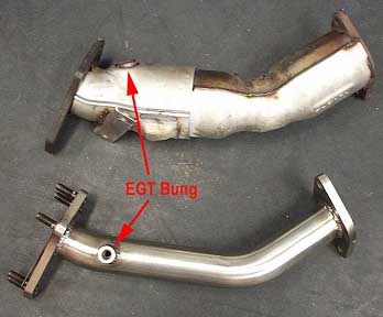

ok, i went all ebay and bought a sweet Perrin UpPipe. turns out it doesn't have a bung for the egt sensor. .. .. ..
guy says there is a "resistor that will prevent any coded issues" provided with the pipe. . .. now my question is, since i will be running the intake, and accessport, is that egt sensor important enough to get a different uppipe, or am i looking to far into this and it isn't something i should worry about. . ...i mean i just dont want to have to worry about frying my turbo because my car didnt sense something was wrong because i removed a sensor. .. . . .
thoughts?

Well, since you're removing the cat in you uppipe it's going to register a different temp anyway causing a CEL even if you put in an uppipe w/ a bung. Hence the resistor which basically bypasses the sensor. Perrin makes good stuff and it's well tested. I'd just follow their directions and not worry about it. It's part of that "risk" you take and disclaimer you agree to when you start modding.

bypass to this problem is easy
get thee to Radio Shack
purchase 1.5 ohm resistors...5 for 99 effin cents
unplug connex from missing sensor, use resistor to bridge the 2 wires, and presto!
internalcombust
