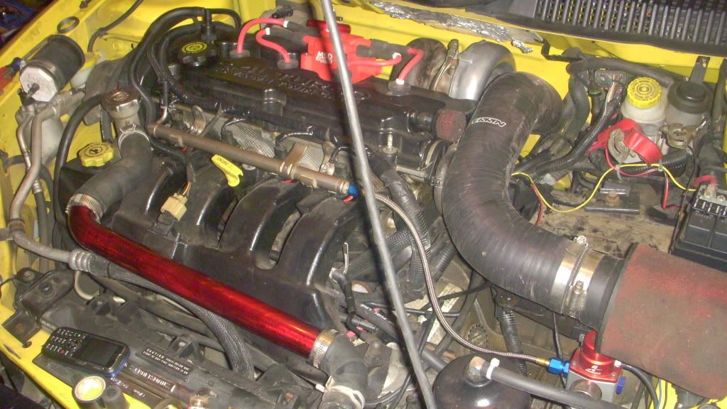

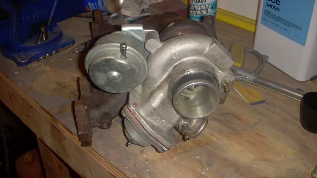

took my car off the road for a while to do a garrett 57trim turbo setup and while it i had the car parked decided to do some body work

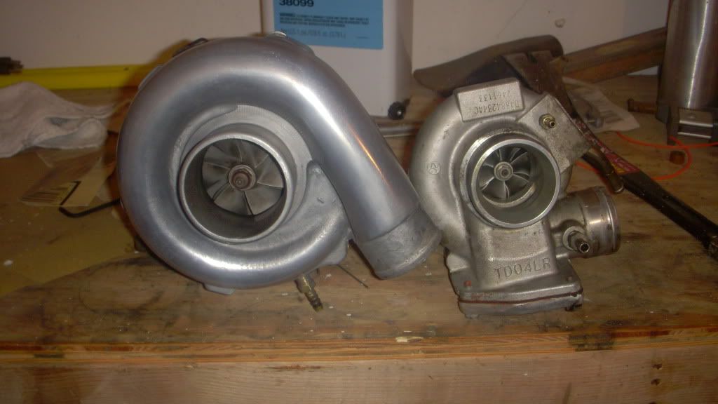

stock turbo beside .57 trim

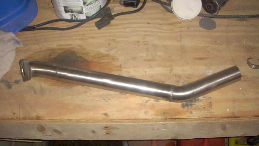

ss 38mm dump tube that was made for me

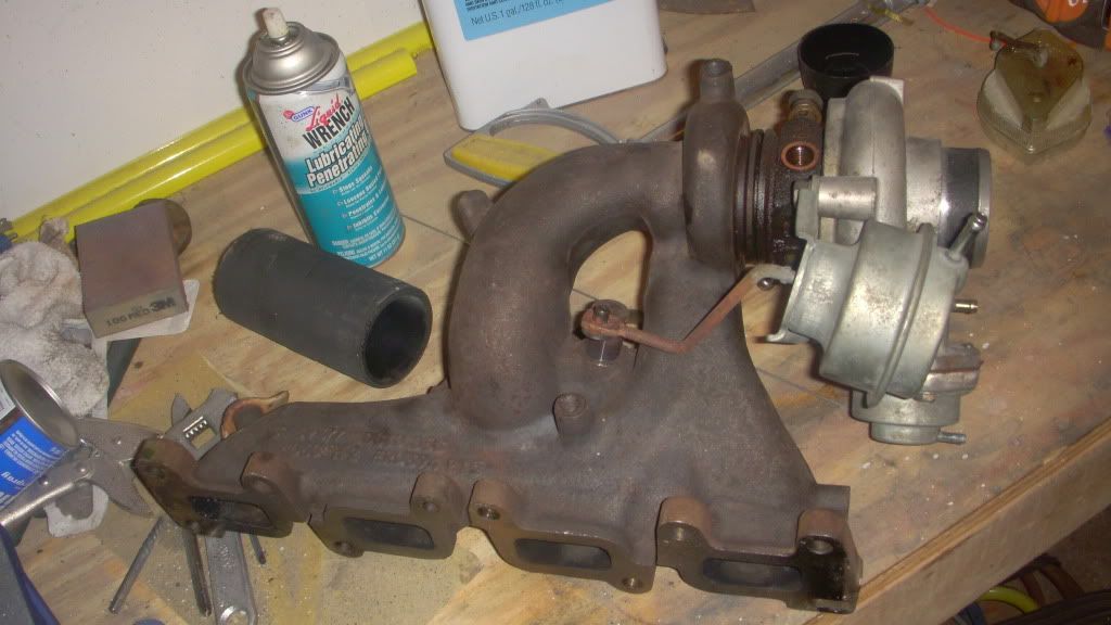

That is a funky looking stock turbo.
yes it is a very funky setup. its a turbofold turbo and manifold in one and the surge valve or blow off valve it bolted directly on the compressor housing and blows off back into the compressor housing

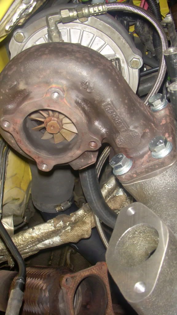

then heres my new turbo and manifold without the o2 housing or external wastegate hooked up

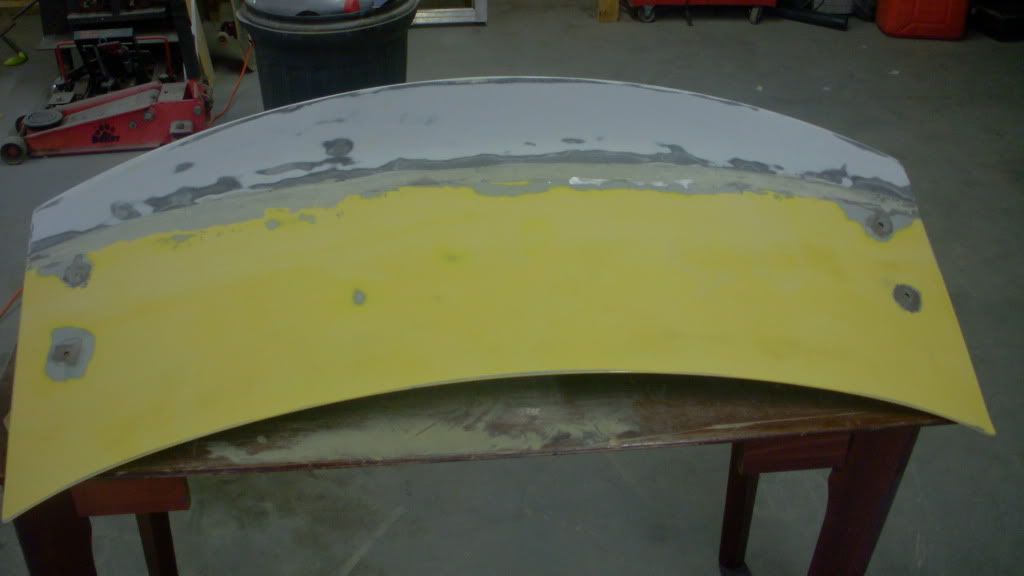

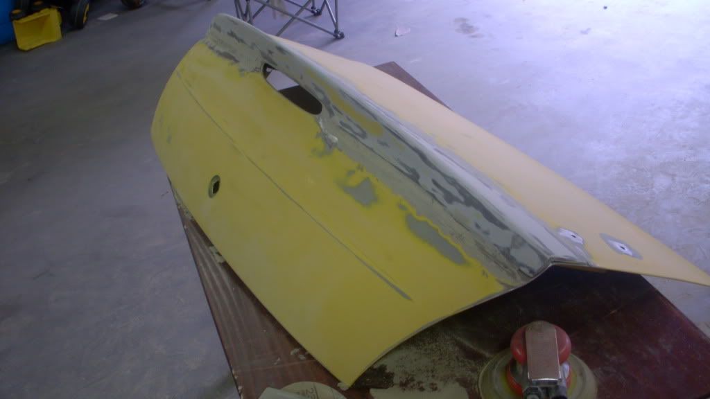

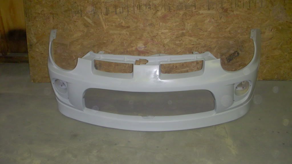

and now for the body work...my front bumper was in awful condition so there was a lot of grinding and repairing on that so laid down a nice thick coat of primer
i bought a pvo carbon trunk lid spoiler off the srtforum and showed up in bad shape and was cracked and didnt line up correctly from previous owner having it molded so i was forced to mold it to my trunk to have it look right

that certainly is a crazy turbo setup. i remember from wrenching on my friends' srt right when it came out that the BOV was integral, but i didnt know the wastegate was too.
i guess its good that the bov charge air goes right towards spinning the turbo back up, but what about all the air that just stopped dead in the front mount and intercooler pipes? it must hurt spool up to have to get that air moving again.
do they give any reason for that funky manifold set up too? it looks like the right two and left two cylinders are pretty unbalanced for flow.

not really sure for the reasoning behind the stock setup but i know its a mitsubishi turbo and is actualy a very powerfull quick spooling turbo....maybe they did is so if something happens with the turbo you have to go through dodge and not a direct mitsubishi replacement.....ya dave the car has been off the road for a couple weeks ive been collecting parts for the swap for a while now, so im waiting for an o2 housing to come in and she will be back on the road hopefully next week sometime
Evan
yeah i remember my friend complaining that dodge made all the parts so that you had to buy it from them in order to mod it. monopoly ftw!
