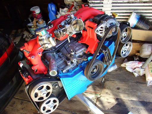

i'll read the thread and comment later, but, wanna buy this? comes with all the stuff i took off (but no ecu) its only a 3 digit price tag.
ummm....when did they put the throttle body facing the other direction?

The intake on WRC motors was reversed with the TB pointing forward so that the length of the FMIC piping would be shorter. This can be done on any Subaru, but you better be excited about fabbing intercooler piping!

OK evan, I'll bite
what IS that motah?
DG
EJ20G, although that can be misleading. the ej20g was made in a bunch of variations, and basically just ment an ej motor made before '95. after 95 most of the motors were open deck because the WRC had made the 300hp regulation. its from a BC legacy,and is the same as the wrx motor but it came with a air/water intercooler (which is sold). the intake manifold is reversed, but can be flipped back around in 5min if you want. yes its for shorter FMIC piping, and i was going to make my own piping anyway so i figured i'd do the shortest route i could. so,
motor pros:
closed deck
good flowing heads (better than usdm wrx)
polished and (slightly) ported throttle body, knife edged butterfly plate.
super clean all around (no leaky seals etc) and on the inside of the valve cover (looks brand new).
comes with headers and uppipe, and any $125 wrx turbo will fit it (or an fp green!)
comes with wire harness, hoses, side feed injector fuel setup (use sr20 injectors to upgrade), all sensors.
came from an automatic car (tend to be in better shape because they're not raced)
coil on plug ignition
sweet paint!
comes with its own webpage!
cons:
HLA adjuster heads
doesn't come with ecu
i might go with a ej257 because i need the airflow. people who know the project know why
also a ej20 swap wont have huge torque, so you might be able to get away with a RS tranny if you treat it nice.
