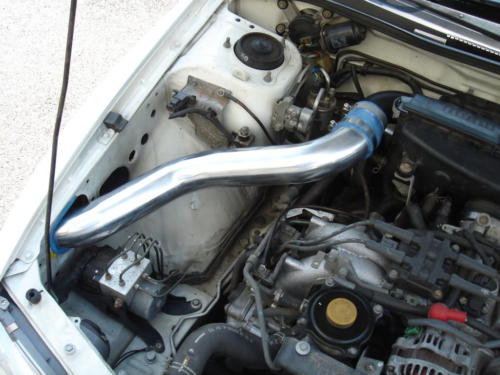

I want to do a Home Depot cold air intake, Pros and cons?

You're not going to gain anything from that intake besides it being shiny. It will flow just as well for an n/a, and the stock one takes in cold air. So it's a moot point.

He asked about intakes, I gave him an option. A higher flowing intake could help. Prob not much, but it's something, and cheap to do, so why not.
