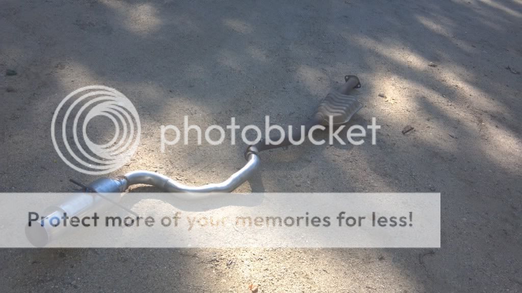

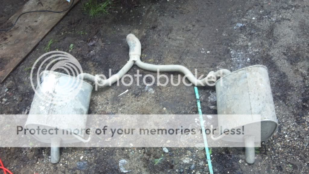

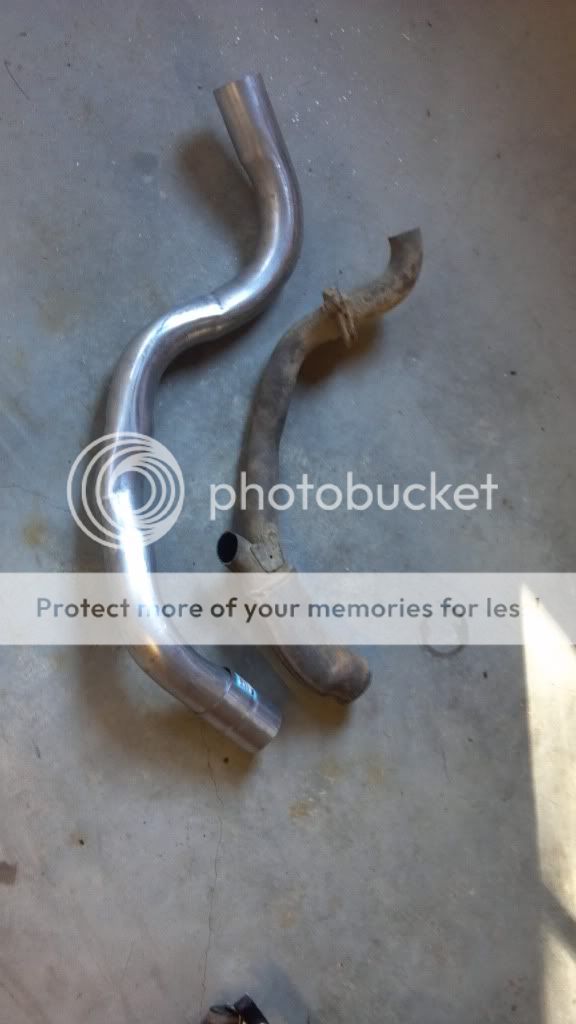

After driving around a silent car (apart from teh dank turbo whistle) for a few months, I got tired of it. Especially since I knew how much more awesome the obxt would sound than my legacy thanks to the unequal length header. I decided to make my own single exit axleback. What I did was chop my catback off right before the y-pipe
hacked off the section I was ditching, then took the remainder to Lifetime in gray to have them replicate the peice in 2.5''.

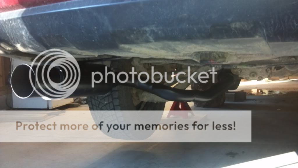

After much thought about what sort of muffler to slap on the end of my masterpiece, I went the ebay route and bought a cheapo china melonshooter. After a weekend of fitting, cutting, tweaking, hammering, and swearing... I got it all welded together and fitting as best as I could.
Trying to stay as "stealthy" as possible I scuffed the cans nice shiny "stainless" finish up with some sandpaper and sprayed the new section of exhaust with 2 cans of black bbq paint I just bought at Advance.
Like I said before: this isn't stainless, isn't mandrel bent, isn't 3", the can cost as much as a case of beer, the welds aren't the cleanest (first time welding in.. 3 years, and all my prior welding was stick, not mig) and it does hang a little too low for my taste. BUT!!! I made this myself and im damn proud of it. So id prefer if you kept whatever flaming you have to yourself.

you should add another hanger to the exhaust to keep it up and out of the way. That way when you are offroading like in the above pictures....you will have no chance of ripping it off!
go to napa or carquest and get a u-bolt clamp and exhaust hangar strap and that should do the trick for the cheap...may not look the prettiest but at least it will be out of the way!
blmpkn
Pascifist Patriot
ive since welded another hanger onto the opposite side. Pulled a tardbox and welded it to the can too high, so it really didnt lift the can any closer to the bumper which is what I was going for. Ill get around to heating that other hanger up and bending it so it fits better/snugger to the bumper when my driveway doesn't resemble grand lake matagamon

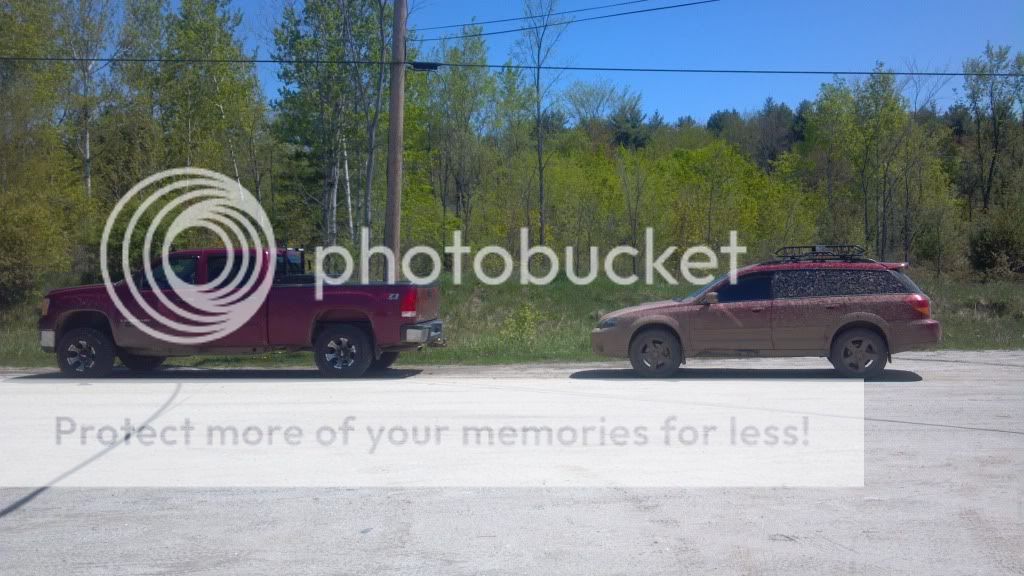

The search was on for another subaru, and I found one... a lifted one!! Booyah! This one would be the red OBXT I bought from Gabe (SUBARUDE) Being naturally higher than a legacy, this wagon was absolutely MONSTEROUS with the 1" lift and 225-60-17 tires it had on it. This car got a bunch of the same treatment as my legacy did.. mud, some trails, field bombing adventures.. so on and so forth. Well I guess I finally came to my senses.. a unibody vehicle with almost a quarter million miles on it does NOT need the stress of being bounced around in the woods and smashing through baby-shit mudholes (as fun as it is) and treating your daily driver like such is just asking for a trip to the garage.. and rides from ma back and forth to work for a week (not ideal).
