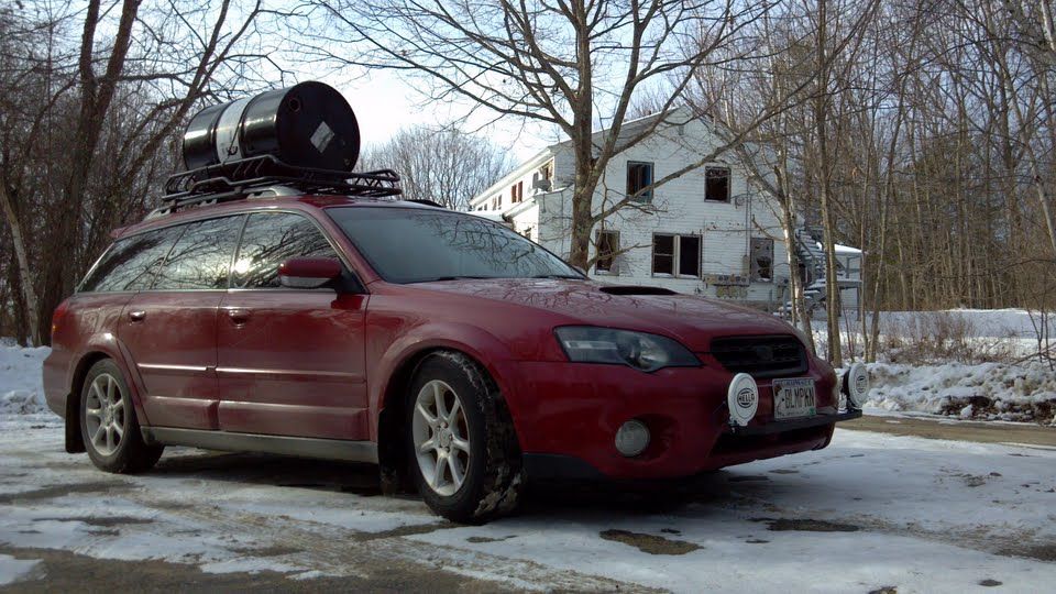

BLMPKN's LOWERED 05 OBXT! **UPDATED 1/8/13**

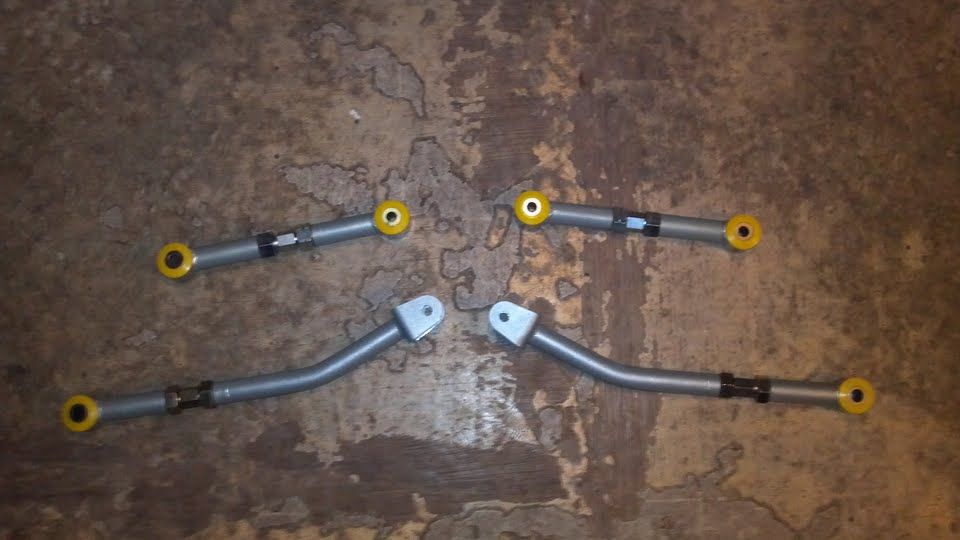

Just ordered Whitelines kit of 4 rear lateral/control arms whatever you wanna call em. Needs adjustable arms to dial in the alignment to where its not just shredding tires.
Should arrive at my door sometime next week, getting installed and realigned friday!

Whiteline rear arms are awesome.

Well start with my new Whiteline control arms
that's them on the floor
that's them on the car! Wow!

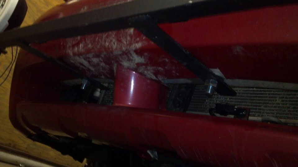

Decided awhile ago I needed a sunday afternoon project while the girlpiece was at work, so I bought 3 feet of square tubing and another 3 feet of flat stock and make a lightbar! Cost me 26$ for materials and the can of truck bed coating I sprayed it with. Its pretty simple, and not as sexy as the rally innovations one.. but it didnt cost me 200+$ and I have the satisfaction of making it myself. Put 4 tabs to mount hellas to, and mounted it to the bumper beam with 7" long half inch bolts/nuts and fender washers
It shakes a little bit, so im going to take a page from the book of rally innovations and add some more flatstock somehow so it will also attach to the two holes the front plate screws to..hopefully stopping the shaking.
Heres a better pic of the bar, and how the car looks at the moment. (not my abandoned house)
